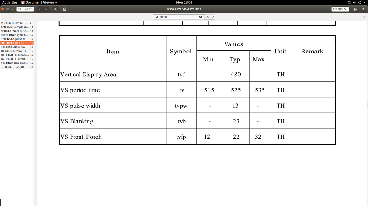

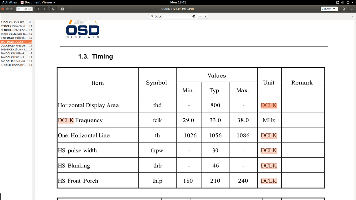

  • Adding Data sheet timing information
