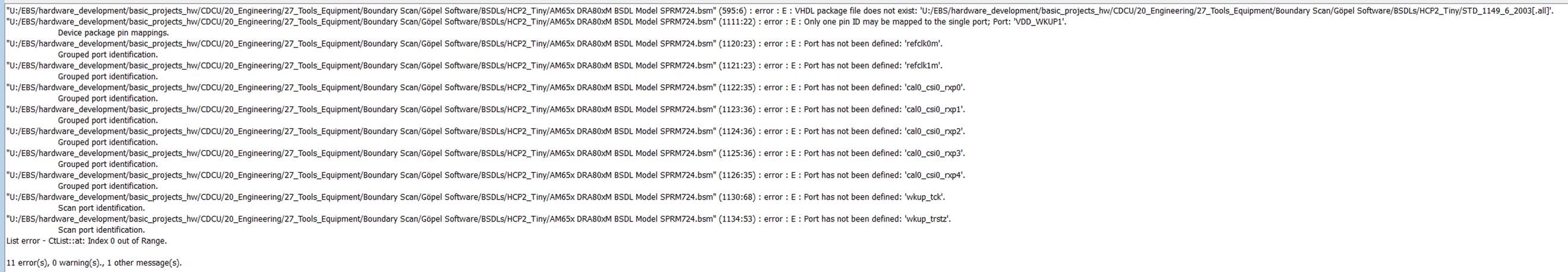

we have tested your bsdl file (DRA804M) and there were some error Messages.

  • Hello Kyle,
    here the full text file.
    {\rtf1\ansi\ansicpg1252\deff0\deflang1031{\fonttbl{\f0\fnil\fcharset0 Calibri;}}
    {\*\generator Msftedit 5.41.21.2510;}\viewkind4\uc1\pard\sa200\sl276\slmult1\lang7\f0\fs22 "U:/EBS/hardware_development/basic_projects_hw/CDCU/20_Engineering/27_Tools_Equipment/Boundary Scan/G\'f6pel Software/BSDLs/HCP2_Tiny/AM65x DRA80xM BSDL Model SPRM724.bsm" (595:6) : error : E : VHDL package file does not exist: 'U:/EBS/hardware_development/basic_projects_hw/CDCU/20_Engineering/27_Tools_Equipment/Boundary Scan/G\'f6pel Software/BSDLs/HCP2_Tiny/STD_1149_6_2003[.all]'.\par
    "U:/EBS/hardware_development/basic_projects_hw/CDCU/20_Engineering/27_Tools_Equipment/Boundary Scan/G\'f6pel Software/BSDLs/HCP2_Tiny/AM65x DRA80xM BSDL Model SPRM724.bsm" (1111:22) : error : E : Only one pin ID may be mapped to the single port; Port: 'VDD_WKUP1'.\par

    "U:/EBS/hardware_development/basic_projects_hw/CDCU/20_Engineering/27_Tools_Equipment/Boundary Scan/G\'f6pel Software/BSDLs/HCP2_Tiny/AM65x DRA80xM BSDL Model SPRM724.bsm" (1120:23) : error : E : Port has not been defined: 'refclk0m'.\par

    "U:/EBS/hardware_development/basic_projects_hw/CDCU/20_Engineering/27_Tools_Equipment/Boundary Scan/G\'f6pel Software/BSDLs/HCP2_Tiny/AM65x DRA80xM BSDL Model SPRM724.bsm" (1130:68) : error : E : Port has not been defined: 'wkup_tck'.\par

    List error - CtList::at: Index 0 out of Range.\par
    \par
    11 error(s), 0 warning(s)., 1 other message(s).\par
  • Hello Michael,
    We've identified a fix for this issue, and the update will show up on the web in the next few days.
    In the meantime, I can send you a draft version for you to check out.  I will send you a message via e2e to hand it off.
