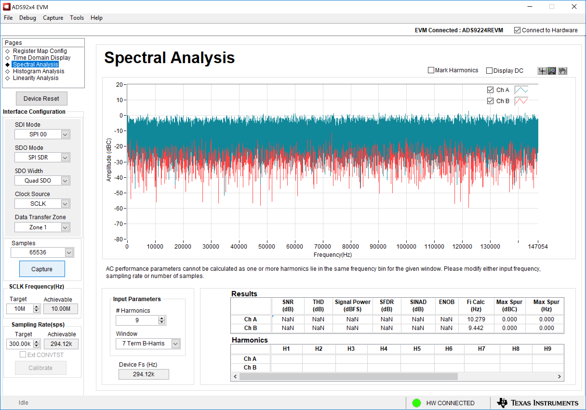

  • ADS9224REVM just arrived, we plugged it in and used the jumpers to short the inputs, and, left them floating and the best noise we can get is -10dbm! what could we be doing wrong, it shows -140dbm in the data sheet / user guides.
    I feel like i must have missed something obvious, i have looked at the data sheets, and looked at it with two other engineers and we cannot work out anything. I tried a laptop with no power supply connected, the best we can get with inputs grounded is around -10db
    I have been able to put a loop antenna in and see signals from my signal source, and i have been able to drop the noise floor by putting a large loop antenna to around -30db. But with both inputs grounded we should see close to the noise floor?

    The ADS9224 is from a different product group. Can you open a new e2e post so it can be routed to the right team for bring-up support? Let me know if you have issues finding the right expert, once you have a new e2e post.
    jian
