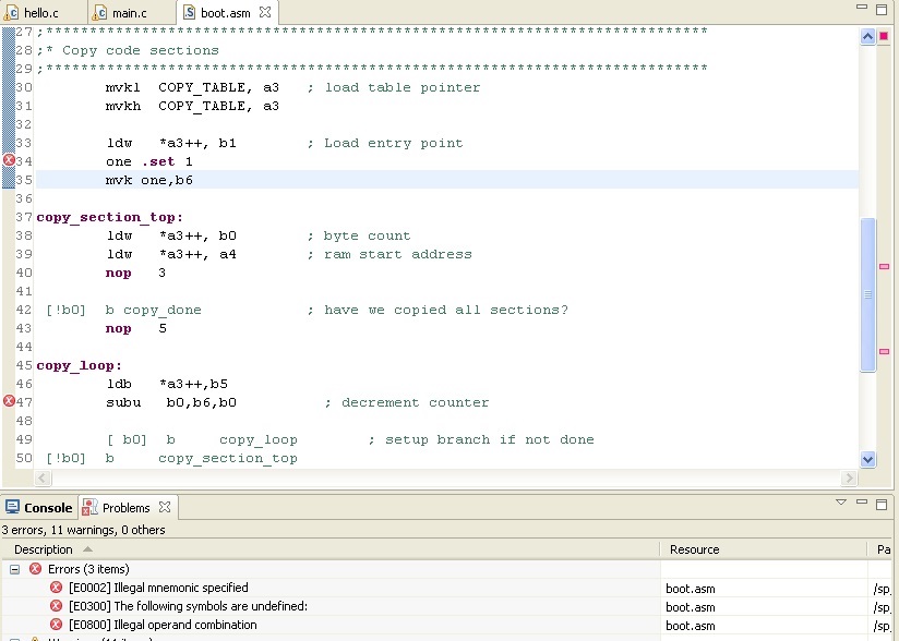

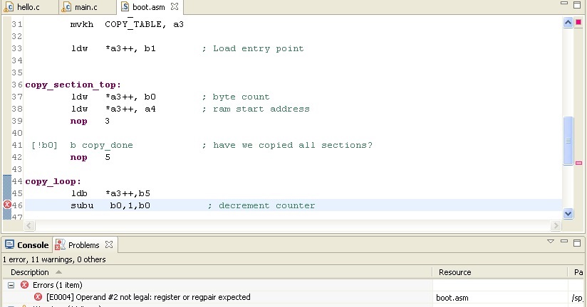

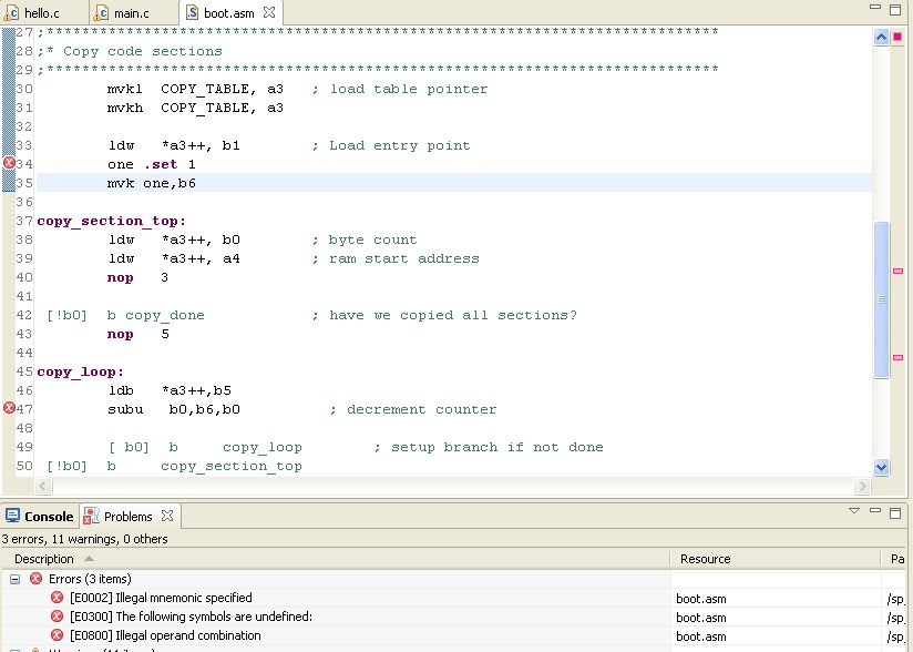

  • Try changing “sub” to “subu”.
    I have tried changing to "subu",but I am getting the following errors.
