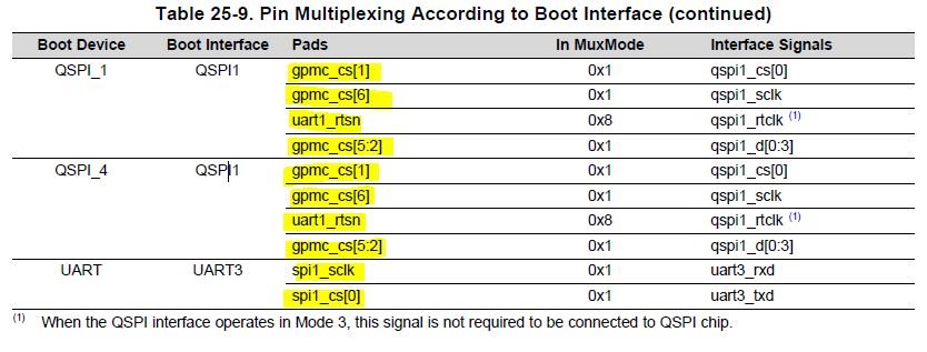

I found ROM code searched below pins for UART and QSPI boot mode in TRM, and all booting devices should attached to these pins, right?
Is there any way to use other pins for booting?
