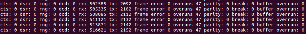

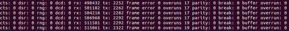

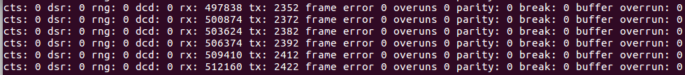

  • Hey Liu,
    I am testing your suggestion. I am testing serial port status with serialstats software. (It is given by TI wiki processors.wiki.ti.com/index.php/Linux_Core_UART_User%27s_Guide)
    I tried different versions of RX_TRIGGER.
    These are the results:
    Serial Comm. 500 kBps, RX_TRIGGER 48 (default) : 56 overrun over 500k RX Byte
    Serial Comm. 500 kBps, RX_TRIGGER 32 : 47 overrun over 500k RX Byte
    Serial Comm. 500 kBps, RX_TRIGGER 16 : 18 overrun over 500k RX Byte
    Serial Comm. 500 kBps, RX_TRIGGER 8 : 19 overrun over 500k RX Byte
    Serial Comm. 500 kBps, RX_TRIGGER 1 : 0 overrun over 500k RX Byte
    According to results, your suggestion is helping but not completely. RX_TRIGGER 1 is  a little bit extreme, but i want to see the results. I can try with higher speeds if you want. What is your opinion?

    I don't have a board which has 4~5 uart ports available, but I spent some time testing on a single uart port on Beaglebone Black with Serial DMA disabled, and found the similar results as you observed - the higher baud rate, the higher fifo overrun frequency. After consulted with our software dev team, the comment is - it is almost impossible to avoid hw fifo overrun without using hw flow control, due to the nature of ISR scheduling in Linux, plus TTY buffer overrun could also happen if user space application doesn't consume data fast enough, which has even lower scheduling priority in Linux. So the recommendation is to use hw flow control to avoid fifo overrun.
