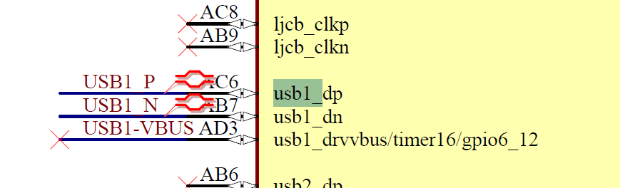

  • hi
    we are using   custom board and the same programs running on the TI EVM can recognize the usb flash disk. but custom board can't .
    no adapter cable used b/n the USB port and the flash drive.
              usb flash disk is directly connected to the board.
    as shown. In addition to the two interfaces for data transmission, there is also a 5V power supply and ground。
    As per the UBOOT code ( branch:origin/p-ti-u-boot-2016.05), the xhci-omap.h file contains below:
    #ifdef CONFIG_DRA7XX_DWC1
    #define OMAP_XHCI_BASE 0x488d0000
    #define OMAP_OCP1_SCP_BASE 0x4A081000
    #define OMAP_OTG_WRAPPER_BASE 0x488c0000
    #elif defined CONFIG_DRA7XX_DWC2
    #define OMAP_XHCI_BASE 0x48890000
    #define OMAP_OCP1_SCP_BASE 0x4A084c00
    #define OMAP_OTG_WRAPPER_BASE 0x48880000
    For the TI EVM, (include/configs/dra7xx_evm.h) we use the USB module @0x488d0000  (which is the USB2 port on TI EVM) as the HOST mode to connect any USB flash driver for mass storage functionality. USB module @0x48890000 (which is the USB3 port on TI EVM) is designated for DEVICE mode for DFU download (Generic Linux) or Fastboot (Android).
    So looking at your schematics, I see that you are trying to connect flash driver to USB module @0x48890000 which is configued for DEVICE mode by default in the u-boot code. Did you make any code change to make it as HOST? This may be the reason why you do not see it getting enumerated.
    If it is configured in HOST, then ideally, once you connect the flash drive, you can measure the USBVDD pin on the USB port and it must measure 5V. Please confirm if you are seeing this? If not is could the software configuration issue.
