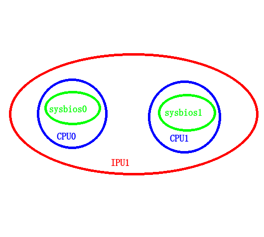

Tool/software: TI-RTOS
IPU1 has two CPUs.
Can theoretically implement a CPU to run a SYSBIOS?
If so, how does the interrupt vector table handle it?
Whether the IPU interrupt vector table address must be 0x00000000?

You can run SYS/BIOS on one IPU core, or SMP mode with two IPU cores.
