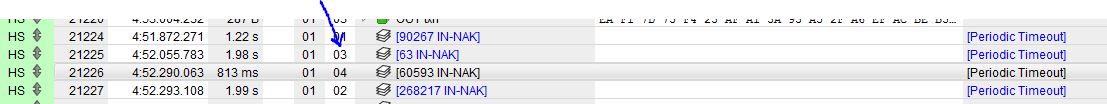

the carlife already connected success,but still occur EAP write timeout when use the IF 3,then I use USB logic analyzer to capture data,result indicate the last data do not sent out.
attachment is a related log, the cat /sys/kernel/debug/tracing/trace since line 26691.

  • Hi Qin Xin,
    Can you point me to the line number in the trace file that point to the EAP write timeout.. what is the data packet content that was not sent out?.
    Also can you share the corresponding logic analyzer file you are referring above? Please denote the exact location in the logic analyser log where you see the data is missing.
    -Praveen
  • Dear Praveen,
    data can't sent out since line 38928 :svp.svc.link-1081  [000] d..3   403.618444: dwc3_ep_queue: ep4in: req ebf12780 length 0/8 ==> -115,
    and the logic analyzer file have already upload to attachment,data can't sent out since index 21225 in the analyzer file.
    https://e2e.ti.com/cfs-file/__key/communityserver-discussions-components-files/791/innak.7z
    thank you.
    Qin Xin.
    Desay SV.
  • Thank you Qin Xin for the details,
    The driver thinks that it has sent out the 8 bytes that it is supposed to send as we see the acknowledgement back and it is even being printed.
    Note that the return value -115 denotes EINPROGRESS and is not an error condition.
    For the request:
    The response of the request transfer:
    line 38929 :3213.76>     svp.svc.link-1081  [000] d..3   403.618454: dwc3_gadget: ep4in: req ebf12780 dma aa7fc000 length 8 last
    line 38930 : 3213.76>     svp.svc.link-1081  [000] d..3   403.618462: dwc3_prepare_trb: ep4in: trb f2b17000 bph 00000000 bpl aa7fc000 size 00000008 ctrl 00000813
    line 38931 : 3213.76>     svp.svc.link-1081  [000] d..3   403.618465: dwc3_gadget_ep_cmd: ep4in: cmd 'Start Transfer' [6] params 00000000 bbc7a000 00000000
    line 38932 : 3213.76>     svp.svc.link-1081  [000] d..3   403.618471: dwc3_gadget: Command Complete --> 0
    But I do see that before this request being send out, there was an ep3out transaction coming from host that never got completed.  See :
    line n38937: 3213.76>     svp.svc.link-1080  [000] d..3   403.333524: dwc3_ep_queue: ep3out: req ebf12680 length 0/8192 ==> -115
    Do we know why this is not being handled?  I see the same in the logic analyze as well. so suspect  the the actual issue started there.
    How often this issue is happening? Who is handling the ep3out and ep4in data? Are we sure the gadget that handle them is not the issue here?
