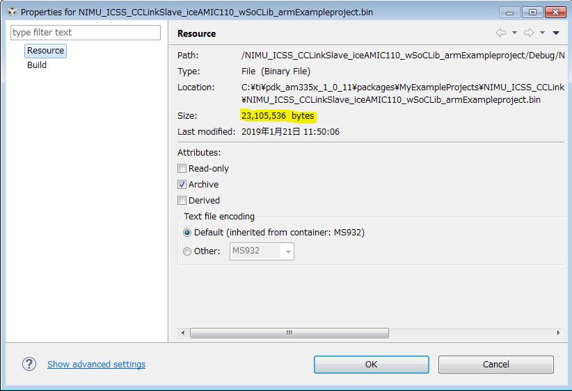

I want to write the following sample project to SPI FLASH of TMDXICE110 and run TMDXICE110 in standalone.
C:\ti\pdk_am335x_1_0_11\packages\MyExampleProjects\NIMU_ICSS_CCLinkSlave_iceAMIC110_wSoCLib_armExampleproject
However, because the size of the bin file of this project is large, it can not be loaded into FLASH.
Could you tell me how to write this project to SPI FLASH on TMDXICE110?
This project's out file is 2,775,096 bytes as follows.
The bin file will be 23, 105, 536 bytes in size.(The size is about 10 times larger)
I changed this bin file to NIMU_ICSS_CCLinkSlave_iceAMIC110_wSoCLib_armExample project_ti.bin by using tiimage.exe.
The size of this file is 23, 105, 544 bytes, which is also big.

    Can you please provide the map file for the application. TO convert the executable to bootable image, the project uses objdump utility which will create a contiguous binary so if there is heap or stack region that is large, it will add that to the binary. To reduce the size of the image, can you refer to the following usage notes, to see if the boot image size reduces:
    software-dl.ti.com/.../index_Foundational_Components.html
    Please refer to : Removing Heap section from application binary section.

  • Sasaki-san,
    I believe I now understand the reason for the increase in size of the application. To understand this a little better, Using “objdump.exe –h” and by opening your .bin file, I was able to notice a 20MB zero buffer in your binary from offset 0x3b400 that ends at offset 0x1600000. Here is the code/data section summary that shows this 20 MB hole in the .out:

    Changes to reduce the size were:
    Reduced code and data memory sections in config_am335x_a8.bld at location pdk_am335x_1_0_11/packages/ti/build/am335x/config_am335x_a8.bld
    APP_CODE_SIZE = 1*MB
    APP_CACHED_DATA_SIZE = 1*MB
    You will need to rebuild the application. Resulting may be in the order of 2-3MB which should allow you to put it on the SPI flash.
    Rahul
  • Hi Rahul-san,
    Thank you for your support!
    I tried that method and the problem improved.
    Sasaki
