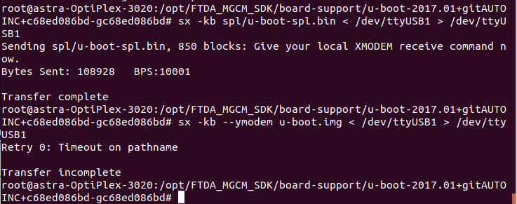

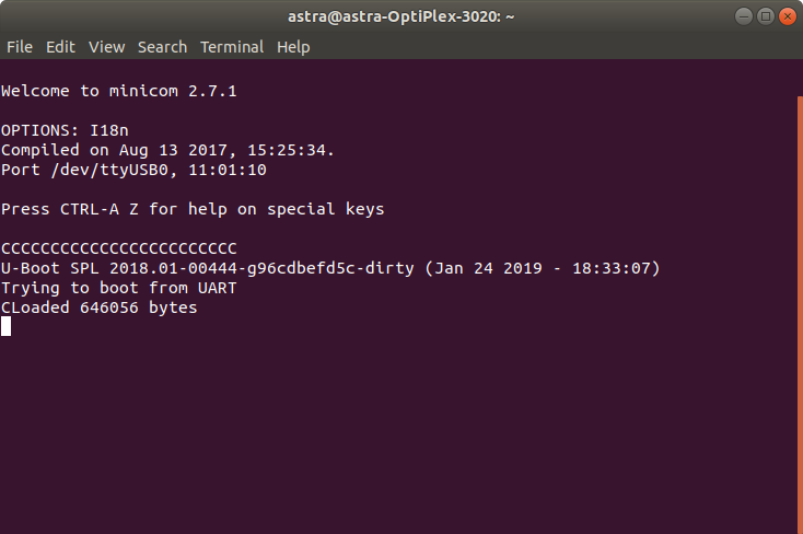

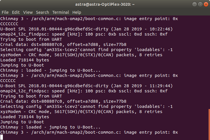

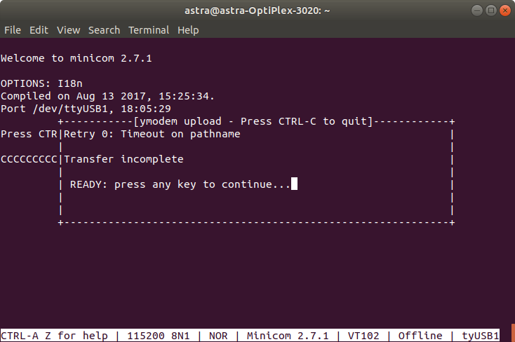

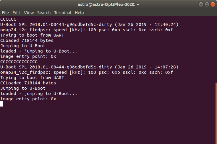

We am trying to boot our custom board with am3359 through uart. We are using minicom to transfer the u-boot-tools.bin and u-boot.img files to the board. We successded in transferring 108kb of data of u-boot-spl.bin file from the /spl folder.
After which when we try to send the u-boot.img file through y-modem we get timeout on sector ACK and Transfer incomplete.
If we try the same through x modem, It says --give your local XMODEM receive command now-- . I'm not sure how to give XMODEM receive command to the board? If I restart the board during this time it starts transferring the file, but stops at 114k bytes and gives timeout on sector ACK msg.
We have also tried the same with picocom, still facing the same problem
Please guide me in booting this custom board through uart.

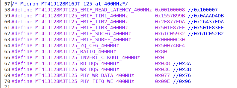

  • Hello Chinmay,
    Have you configured the DDR timings? On which design (AM335x GP EVM, AM335x SK or BBB) your board is based? Which is the PMIC used on your board?
    Kemal
  • Hi Kemal,
    Our board is based on the AM3359ICEv2 design, It uses the same PMIC used in the AM3359ICEv2 board. We have run the EDMA and DDR test from the GEL file which passed successfully. I have attached the GEL file and the DDR timing reg tool and ratio seed xls files along with the log of results for the DDR DataTransfer check and EDMC test Scripts we ran.
    TMDXICE3359.gel  8420.RatioSeed_AM335x_boards.xls  4201.AM335x_DDR_register_calc_tool.xls

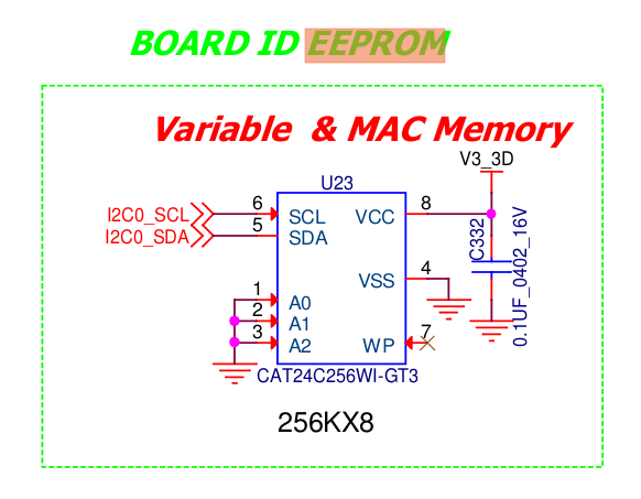

  • Do you have an EEPROM on that board? If not, how do you skip the EEPROM checks?
  • We have EEPROM on the board but i think we are not using it as of now.  Do we need to program the eeprom and how to do it?
  • You can program it later once you get in U-Boot or Linux console as shown in this, this and this post. Can you apply this patch and check whether the spl loading works?

  • HI Kemal,
    Applied the Patch and tried to transfer both spl/u-boot-spl.bin and u-boot.img files. The u-boot-spl.bin file gets transferred successfully via the x-modem after which when i try to send the u-boot.bin file through y-modem,
    It gives me    --> Retry 0: Timeout on pathname
                             --> Transfer incomplete

    Kindly help us in bring up u-boot either through UART or through NAND.
  • It sounds to me that somehow in your U-Boot the proper DDR timing are not selected again. Can you attach the changes you made in your U-Boot collected with this command?
    cd <Processor SDK>/board-support/u-boot-<version>/
    git diff > u-boot-changes.log
  • Hi Kemal ,
    How/where do we change the DDR timings for u-boot ? We have set the modified DDR timings in the GEL File for testing the DDR through CCS and it seems to be working fine. We are using u-boot-2017.01 . Kindly guide us in bringing up u-boot-spl.bin on our custom board.
  • You must execute the listed steps linked in this post and configure your DDR parameters.
  • Dear Kemal,
    Our EEPROM in custom board is empty. I think that is the reason we were not able to boot u-boot-spl. How to Program the Eeprom and with what values ? Or Can we By-pass the Eeprom check ? If So where/what should we modify?
    We have tested the same spl bin file in the custom board from by putting the eeprom from the ICE board onto our custom board. We are now able to send the u-boot-spl.bin file and u-boot.img successfully through UART, But we are not getting the U-boot Prompt. It is stopping after loading u-boot.img file through y-modem.
    I have already done the steps shown in the above link and got the Timing values. I have used the same in the GEL Script File and checked the DDR through CCS, It seems to be working fine. I have put the same in the ddr_defs.h file. Is there any other place we have to modify to make U-boot work?
  • Here in this table you can find the ID Memory Contents of ICE board. You can program the EEPROM once you get in U-Boot console as is shown in the listed links in this post or use an external ISP EEPROM programmer to program it separately. You can use the patch from the same post to harcode the board name and skip the EEPROM checks.
  • Kindly help in getting this u-boot prompt. We will program the EEPROM later.
    What are the changes to be made to get the u-boot successfully booted for a custom board. How to get debug print on u-boot?
  • You can add #define DEBUG line in <Processor SDK>/board-support/u-boot-<version>/include/configs/am335x_evm.h file to make the output more verbose and see where exactly it hangs. If you met the `.rodata' will not fit in region `.sram' error while compiling MLO with defined DEBUG flag, please refer to this post.
  • Dear Kemal,
    I have now added the #define DEBUG line in am335x_evm.h file and comiled u-boot again. After transferring the u-boot.img file we are getting the following prints in console
    Jumping to U-Boot
    loaded - jumping to U-Boot...
    image entry point: 0x
    Screenshot:
    Any other modifications to be done? this is getting stuck in /arch/arm/mach-omap2/boot-common.c at line no 227
    Below is the function snippet  :

  • Dear Kemal,
    Kindly find the screenshot attached ;
    We are still stuck in the same point. Kindly help in resolving this issue.
  • Dear Kemal,
    After some debugging, I have found that it is getting stuck in the following function where it is trying to call the fdt_getprop() function for the type 'loadables' which is failing.
     * spl_fit_get_image_name(): By using the matching configuration subnode,

    Please guide me in resolving this issue.
  • Please, apply this patch to fix this issue.
    git apply 0001-ICE-V2-Change-U-Boot-SPL-UART-from-UART3-to-UART0.patch
