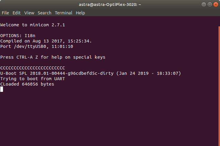

I am trying to boot our custom board with am3359 through uart. We are using minicom to transfer the u-boot-tools.bin and u-boot.img files to the board. We succeeded in transferring 108kb of data of u-boot-spl.bin file from the /spl folder.
After which when we try to send the u-boot.img file through y-modem we get timeout on sector ACK and Transfer incomplete.
If we try the same through x-modem, It says"give your local XMODEM receive command now" . I'm not sure how to give XMODEM receive command to the board? If I restart the board during this time it starts transferring the file, but stops at 114k bytes and gives timeout on sector ACK msg.
We have also tried the same with picocom, still facing the same problem
Please guide me in booting this custom board through uart.
Screen shots attached:
  • Hi Biser,
    I have tried the procedure mentioned from the link u have provided, but was still unable to transfer the u-boot.img file through the -ymodem.
  • You'll need to make sure to rebuild the u-boot images so they are compatible with booting over UART.
    Also I recommend using Teraterm

  • Dear Marcus,
    I'm using ubuntu linux, hence can't use Teraterm.
    I'm able to transfer the spl/u-boot-spl.bin file through minicom using xmodem. But after the successful transfer, I'm not getting the "CCCC.." print in the com port. Is there something wrong in my u-boot-spl.bin file ?
    If i try to transfer the u-boot.img file through x-modem before transferring u-boot-spl.bin , The transfer starts but stops after sending 114k bytes everytime.
    We are also running the am335x-boot.dds script file to check for Tracing vectors to help in analyzing any boot issue. Attaching the Log FIle and the Script file.  Need help in analyzing this  log file.

  • I verified I could load spl and u-boot over UART using minicom, but I performed the transfer steps from within my minicom session.  Instead of using the command line options to transfer files, use the "Send" option while within minicom.
  • We have tried Sending the u-boot-spl.bin and u-boot.bin files through minicom , but we do not get the CCCC print after sending the u-boot-spl.bin file. It seems to be get hanged after this and does not even take the u-boot.img file from y-modem.
  • Note:you should be loading the u-boot.img (not u-boot.bin) file over y-modem.
    Also since we know UART boot is working on the EVM and unsure of the reliability of your custom board and your minicom (linux) configuration, I recommend verifying UART boot on a known good hardware platform; specifically the AM35x EVM.  Do you have an AM35x EVM to validate and compare the UART boot operations?
  • Dear Marcus,
    Our EEPROM in custom board is empty. I think that is the reason we were not able to boot u-boot-spl.
    We have tested the same spl bin file in the custom board from by putting the eeprom from the ICE board onto our custom board. We are now able to send the u-boot-spl.bin file and u-boot.img successfully through UART, But we are not getting the U-boot Prompt. It is stopping after loading u-boot.img file through y-modem.
    What should we do to get the u-boot Prompt ?
  • Be sure your u-boot source is referencing the correct UART port.  If you are using at different UART port than what's used on the AM3x EVM, then you'll need to change the UART configruation.
