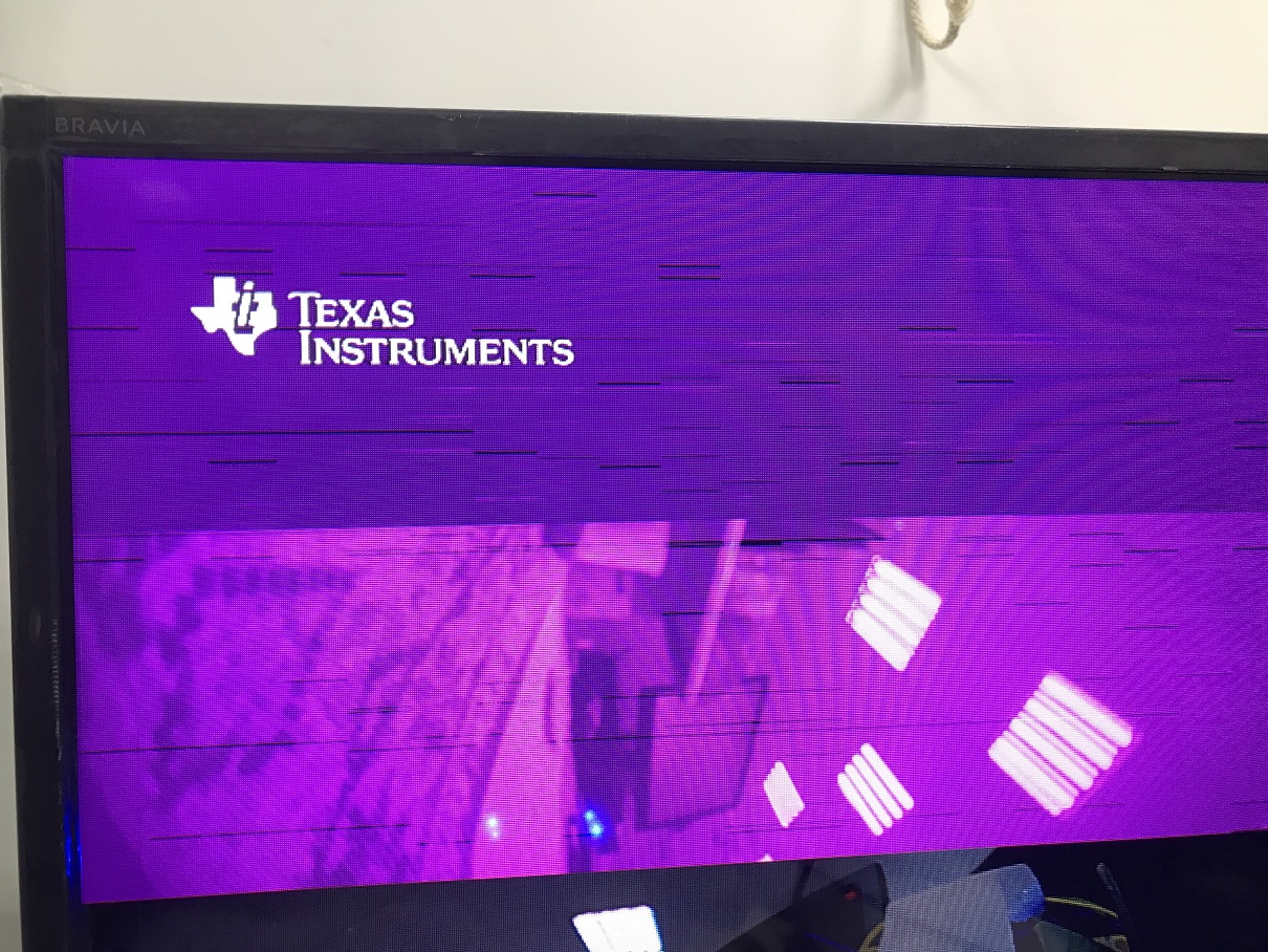

Hi Sir,
My HW is TDA2x CPU board + Vision Board + daughter board + OV1652x sensor and SDK is PROCESSOR_SDK_VISION_03_04_00_00 with TDA2XX_EVM_LINUX_ALL define.
I select use-case "4CH VIP LVDS capture + SGX MOSAIC + DISPLAY" .
I changed the code like below steps:
1. I found the image capture buffer address in "SgxFrmcpyLink_drvDoProcessFrames" function, image point is "pVideoCompositeFrame->bufAddr[0][0]"
2. I try to modify the image data or clear data buffer in this function.
    ex.   compostive_video_buf_addr = pVideoCompositeFrame->bufAddr[0][0];
             memcpy(compostive_video_buf_addr, 0x00, 115200);
or
 for (int i=0; i<57600; i++)
  compostive_video_buf_addr+i = 0xBBBBBBBBBBBBBBBB;
3. compiler and select use-case,
4.TV shows  a strange image, I attached the image file.
The image seems noisy and mix up the original capture image.
I have no idea whta's happen and how to fix it.
