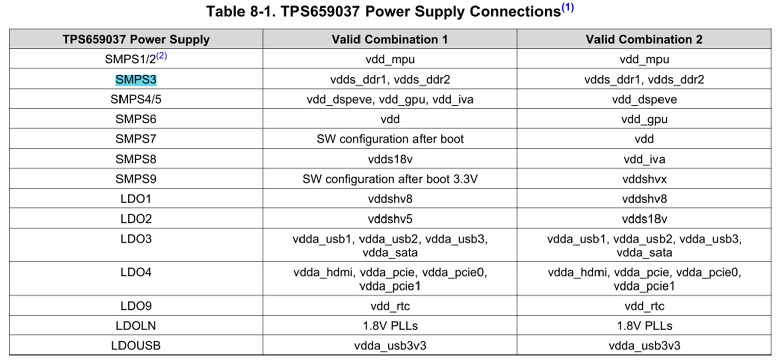

Is there power spec for AM5728 on the pins for “valid combination 1” and “valid combination 2”?
Customer  power designer would need the max current spec that can help them to run simulation to see if the board copper plane/trace are sufficient or not.
