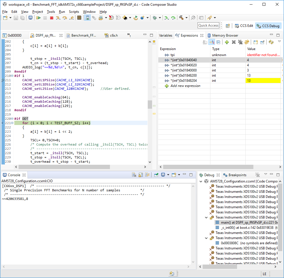

    I don't have your CCS project so I created one and tested. You need to make sure you initial test condition what it is before you run for comparison, on the DSP C66x core, look at:
    L1DCFG 0x01840040 change to 0
    L1PCFG 0x01840020 change to 0
    L2CFG 0x01840000 change to 0
    MAR128 0x01848200 change to 0xc
    MAR129 0x01848204 change to 0xc
    Then you run the
    CACHE_setL1PSize(CACHE_L1_32KCACHE);
    CACHE_setL1DSize(CACHE_L1_32KCACHE);
    CACHE_setL2Size(CACHE_128KCACHE); //USer defined.
    CACHE_enableCaching(64);
    CACHE_enableCaching(128);
    CACHE_enableCaching(129);
    Make sure above are: 4/4/3/0xD/0XD. Then you benchmarking again. Let me know if you get different results. Note for some reason the _itoll() didn't work properly, I didn't debug. But from TSCL and TSCH, I knew it is faster.
    Regards, Eric

    I tested on AM5728 IDK EVM, using the standard GEL to initialize the SOC, including the DSP PLL. I can see that cache on is about x13 faster. One difference is I used -O3 optimization for your code, the other changes are minor.
    Attached is the CCS project and printout below.
    Cache off
    start 488821, stop 580438111, diff 579949281, TSCH 0, c[1] 8
    Cache on
    start 635032235, stop 678885963, diff 43853725, TSCH 0, c[1] 8
    Regards, Eric
