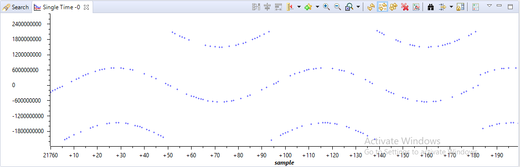

Hi experts!
I changed "MCASP_Audio example" generated for evm572x (I've got beagleboard x15) to use interrupts instead of EDMA. I didn't use "mcasp_drv" but CSL mcasp library (sequences of programming took from TRM). All parameters of I2S-mcasp configuration used are the same as in example.
My problem is that MSB has random value - it can be see on the picture attached: (this is sinusoidal signal generated on the PC sound card and connected to board input)
(As U2 is used) I imagine that middle part of samples are with correct values. So samples that are placed near the bottom of the chart should not have '1' on MSB and samples from the top shouldn't have '0' on the first bit.
Have you ever encounter problem like this? Have you any suggestion where to look? I really will appreciate any halp.
Configuration of Codec is the same as in example ("AIC31 drv") with the configuration. My mcasp configuration is below:

  • Ok, I found a reason. Sorry for spam.
    Problem was with Transmit bitstream clock polarity.
    AIC3104 by default is sampling on RISING EDGE. So mcasp configuration should set FALLING EDGE for sampling on bitclock because of dealy(???).
    I changed:
    McASPTxClkPolaritySet(CSL_DSP_MCASP3_CFG_REGS,
    MCASP_TX_CLK_POL_RIS_EDGE); // 1 bit shifted so rising
    to:
    MCASP_TX_CLK_POL_FALL_EDGE); // 1 bit shifted so rising
