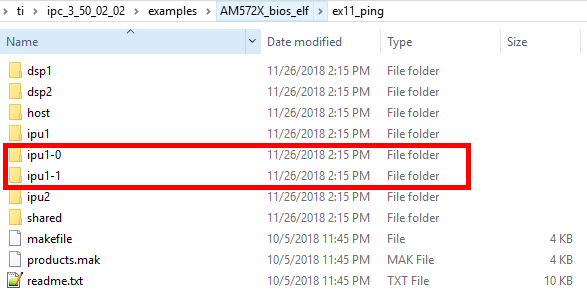

CCS: Why IPC-example only these two projects are not compiled
    This is a bug.
    Please add "ipu1-0" and "ipu1-1" to the PROCLIST in the makefile ~\ipc_3_50_02_02\examples\AM572X_bios_elf\ex11_ping\makefile to fix this issue.
    # edit PROCLIST list to control how many executables to build
    PROCLIST = dsp1 dsp2 ipu1 ipu2 ipu1-0 ipu1-1 host
