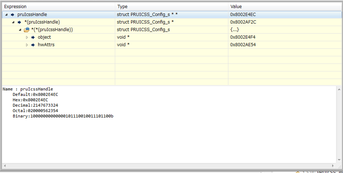

  • For debugging, few things to check would be
    1) Verify that the “pruIcssHandle” variable in initialized before it is sent to the PRUICSS_pruIntcInit() function.
    →This is the capture when program is suspended at the breakpoint of PRUICSS_pruIntcInit() line in motorControlICSSInit() function.

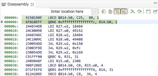

    2)      Halt the ICSS0-PRU1 and manually step through the code. Is it always stuck at the same instruction?
    →Yes, ICSS0-PRU1 went back and forth between the addressed between 0x04 and 0x08 respectively as below capture.

    This assembly code you are showing the PRU stuck in corresponds to the FOC_IDLE loop in the pru_adc_sampling.asm file. Here is the corresponds assembly in the file:
    FOC_IDLE:
    ; Wait till host is ready, Indicate via FOC_CONTROL_OFFSET
    LBCO &TEMP_REG_1.b0, PRU1_DMEM, FOC_CONTROL_OFFSET, 1
    QBNE FOC_IDLE, TEMP_REG_1.b0, FOC_CONTROL_ENABLE
    This means that the PRU is constantly reading it's local memory (DMEM + 0x50) and expecting a 1 to be there which corresponds to an enable flag that should be set from the Arm core. Without this the PRU never begins reading ADC data and never triggers the Pwm_ISR() function.
    The Arm core should set this bit at the end of the pwmADCAppInit function in the foc.c file:

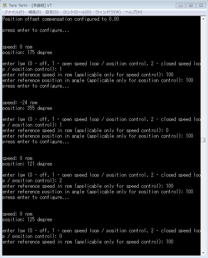

  • Hi Jason,
    Thank you for your reply.
    The closed loop did not run after modifying ed_step and ed_turn_res.
    But position data displayed in terminal is good after modifying as below.
    in main.c :
    cur_position = (float)foc_get_angle() / (float)pow(2, 17) * (float)360;
    Speed data could not be displayed properly in terminal.
    So I think speed calculation is something wrong...
    The result of demo is as below.
    After closed loop setting, motor is freezing and JTAG is disconnected forcibly.
    U-SK

    The place that you are stuck in the tamagawa_app.c appears to be the handshake portion of the ARM and PRU communication. Can you tell me where the Tamagawa PRU is stuck when your Arm core gets stuck at this spot?
