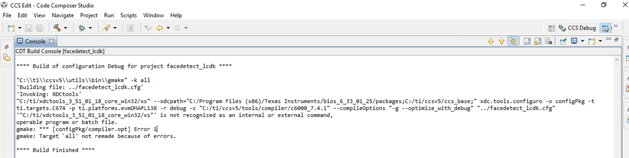

    When i Build the code iam getting the below error, I have installed all the necessary softwares din't find what is the problem
    Do you have XDCtools installed? Does the path "C:/ti/xdctools/3_51_01_18_core_win32/xs" exist on your system?
    I suspect you need to modify the XDC_CG_ROOT variable in project properties -> CCS Build -> Variables to point to the correct directory.
    Yes, now I am able to get the .out file and I got the output too.
    Thank you very much for your advice
