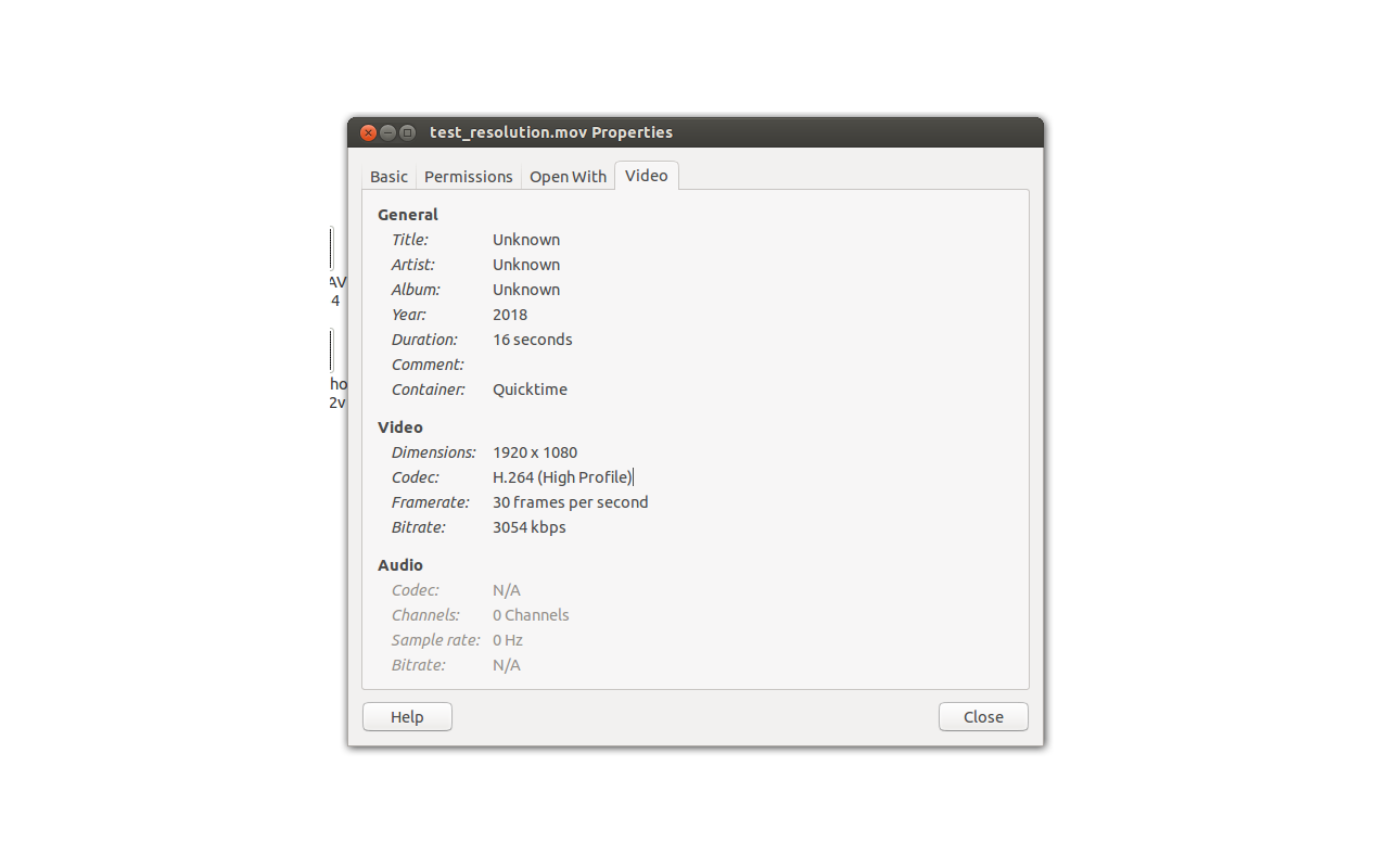

    But on the parser output I see height is reported as 1088. It seems it is aligned to 16.
    If you  check the file on PC I see the resolution is 1920x1080.

    In my previous answer, I forgot to add the result of the first pipeline on PC :
