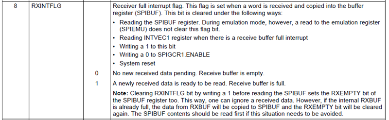

    The problem is that the RXINTFLG Bit in SPIFLG Register is not reset when I tried to reset.
    I tried to clear by two ways according the datasheet (I call the two ways consecutively):
    - Writing a 1 to this bit
    - Reading the SPIBUF
    But the bit is not clear and it looks a new byte is in SPIBUF.
    I checked in your documents (SPRZ285.pdf and SPRZ232F.pdf) that other TMS320 boards  have the same problem because a silicon error.
    Do you know how resolving this error?

  • Hi Lucia,
    Table 28-13 in the C6748 TRM lists all the ways to clear this bit:
    Sahin
    I had seen this table in the datasheet. However, this bit is not reset always using only one way. Sometimes, the bit is reseting only after using two ways consecutively how SPRZ285.pdf and SPRZ232F.pdf is explaining.

    I'll need to reach out to the design team to confirm if it's a silicon bug or not. I will post a reply here once I have an update.

  • You should not assume which order the TX and RX flags happen. You might be overlooking that the flags are one word off due to the shift register underneath. Some possible example code:
    void SPITransfer(unsigned int uiSPIReg,
                     int n,
                     const unsigned char *ptx,
                      unsigned char *prx)
      int nrx = n;
      int ntx = n
      ClearSPIFlagReceptionBuffer(uiSPIReg);
      (void)SPIDataReceive(uiSPIReg); // Dummy Read
      while(ntx && nrx)
        uiStatusSPI = SPIFlagStatus(uiSPIReg);
        if (uiStatusSPI & SPI_SPIFLG_TXINTFLG_UI)
          if (ntx)
            SPITransmitData1(uiSPIReg, *ptx++, CS_NONE_UI);
            ntx;
        if (uiStatusSPI & SPI_SPIFLG_RXINTFLG_UI)
          if (nrx)
            *prx++ = SPIDataReceive(uiSPIReg);
             nrx--;
    The first transmit byte will move from the TXBUF into the shift register almost instantly.
    The second transmit byte can written to the TXBUF very soon after the first.
    The third transmit byte has to wait for first to get out the shift register. That happens at the same time as the first receive byte gets moved from the shift register to RXBUF. So the 3rd TXINT and 1st RXINT occur at the same time and any order.
