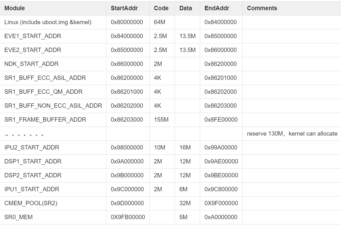

TDA2PXEVM: where is the timers being allocated for EVE?
Part Number: TDA2PXEVM
Other Parts Discussed in Thread: SYSBIOS
We enabled the EVE1 and EVE2, but the other cores fail to attach to EVE2, and remote cores boot by kernel. The expert from TI suggest to check the timers  being allocated for EVE. I can not find the timers for EVE in .dts files. So, where is the timers being allocated for EVE?
Thanks a lot
Terence
    Please find the log in the attachment.

     [HOST] [IPU1-0]     16.480296 s:  ***** IPU1_0 Firmware build time 16:03:25 Jan 24 2019
     [HOST] [IPU1-0]     16.480479 s:  *** SYSTEM: CPU Frequency <ORG = 212800000 Hz>, <NEW = 212800000 Hz>
     [HOST] [IPU1-0]     16.483102 s:  SYSTEM: System Common Init in progress !!!
     [HOST] [IPU1-0]     16.484109 s:  UTILS: CIO: Init Done !!!
     [HOST] [IPU1-0]     16.484200 s:  SYSTEM: IPC init in progress !!!
     [HOST] [IPU1-0]     16.484292 s:  SYSTEM: Attaching to [IPU2] ...
     [HOST] [IPU1-0]     16.669188 s:  ***** tda2px IPU2 Firmware build time 16:03:27 Jan 24 2019
     [HOST] [IPU1-0]     16.730067 s:  SYSTEM: Attaching to [IPU2] ... SUCCESS !!!
     [HOST] [IPU1-0]     16.734886 s:  SYSTEM: Attaching to [DSP1] ... SUCCESS !!!
     [HOST] [IPU1-0]     16.737906 s:  SYSTEM: Attaching to [DSP2] ... SUCCESS !!!
     [HOST] [IPU1-0]     16.760202 s:  SYSTEM: Attaching to [EVE1] ... SUCCESS !!!
     [HOST] [IPU1-0]     17.543677 s:  SYSTEM: Attaching to [EVE2] ...
     [HOST] [IPU1-0]     18.543707 s:  SYSTEM: Attaching to [EVE2] ...
     [HOST] [IPU1-0]     19.543738 s:  SYSTEM: Attaching to [EVE2] ...
     [HOST] [IPU1-0]     20.543768 s:  SYSTEM: Attaching to [EVE2] ...
     [HOST] [IPU1-0]     21.543768 s:  SYSTEM: Attaching to [EVE2] ...
     [HOST] [IPU1-0]     22.543799 s:  SYSTEM: Attaching to [EVE2] ...
     [HOST] [IPU1-0]     23.543829 s:  SYSTEM: Attaching to [EVE2] ...
     [HOST] [IPU1-0]     24.543860 s:  SYSTEM: Attaching to [EVE2] ...
     [HOST] [IPU1-0]     25.543890 s:  SYSTEM: Attaching to [EVE2] ...
     [HOST] [IPU1-0]     26.543921 s:  SYSTEM: Attaching to [EVE2] ...
     [HOST] [IPU1-0]     27.543951 s:  SYSTEM: Attaching to [EVE2] ...
     [HOST] [IPU1-0]     28.543982 s:  SYSTEM: Attaching to [EVE2] ...
     [HOST] [IPU1-0]     29.544012 s:  SYSTEM: Attaching to [EVE2] ...
     [HOST] [IPU1-0]     30.544012 s:  SYSTEM: Attaching to [EVE2] ...
     [HOST] [IPU1-0]     31.544043 s:  SYSTEM: Attaching to [EVE2] ...
     [HOST] [IPU1-0]     32.544073 s:  SYSTEM: Attaching to [EVE2] ...
     [HOST] [IPU1-0]     33.544104 s:  SYSTEM: Attaching to [EVE2] ...
     [HOST] [IPU1-0]     34.544134 s:  SYSTEM: Attaching to [EVE2] ...
     [HOST] [IPU1-0]     35.544165 s:  SYSTEM: Attaching to [EVE2] ...
     [HOST] [IPU1-0]     36.544195 s:  SYSTEM: Attaching to [EVE2] ...
     [HOST] [IPU1-0]     37.544226 s:  SYSTEM: Attaching to [EVE2] ...
     [HOST] [IPU1-0]     38.544256 s:  SYSTEM: Attaching to [EVE2] ...

  • Hi Terence,
    Sorry about the delayed response.
    I have few doubts over the memory used. What's the available RAM? And how much memory is reserved? Can you please provide the output of cat /proc/meminfo on the target.
    Also I understand LPAE is disabled from Linux kernel?
    Shravan
  • Hi Shravan,
    1. Please find the output of cat /proc/meminfo when attaching fail in the attachment. It seems that some memory is  free.
    2.Yes, We had  disabled LPAE in kernel  .config.
    Thanks a lot
    Terence

  • Hi Terence,
    I see that the memory available for Linux is quite low. Is it possible to reduce the CMA size for other cores (IPU/DSP/EVE). You would need to make a change in the kernel DTS and the 'mem_segment_definition_linux.xs' file in Vision-SDK.
    Also since you're not using DSP2, can you ensure that the DSP-2 is disabled from the DTB and the dsp2_cma_pool is diabled as well?
    The issue with loading of EVE cores could be due to memory constraints for kernel.
    Shravan
  • Hi Shravan,
    Thanks a lot.
    1.How much memory  the Linux need?  According to your suggestion, I will try to reduce CMA size.
    2.We have only 512M DDR, according to VisionSDK_UserGuide_MemoryMap.pdf from TI visionSDK 03 05, we have changed it. Below is our memory map, Could you give me some advice?
  • Hi Shravan,
    On the other hand, when the memory available for Linux is low, sometimes, why it will lead to remotecore run fail?
    Terence
  • Hi Terence,
    Thank you, can you please share your Linux DTB as well.
