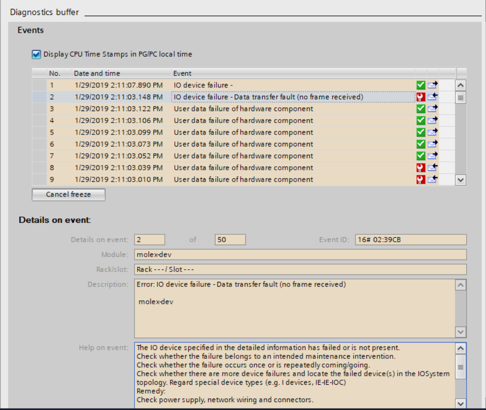

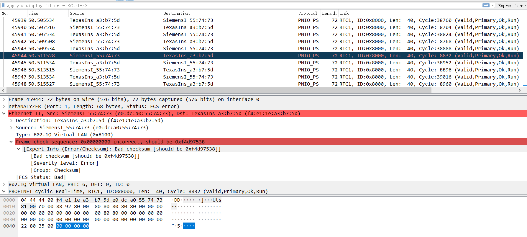

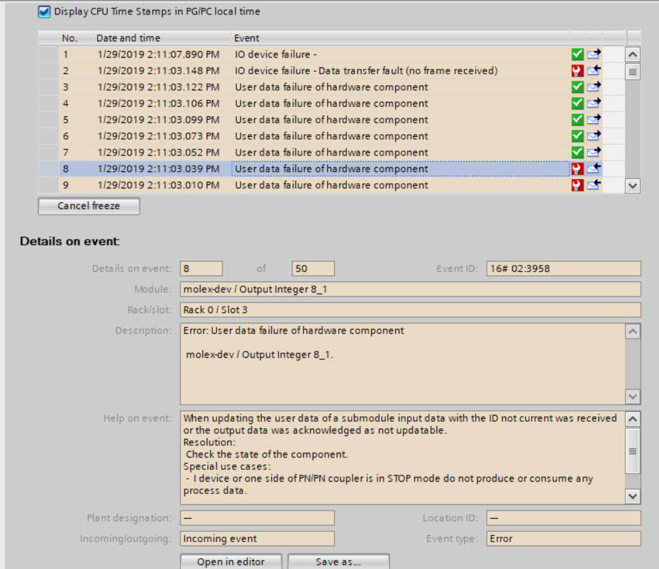

After the PROFINET demo based on processor_sdk_rtos_am335x_4_02_00_09 is ported to my board,and it succeed to establish communication with Siemens S7-1200 PLC. But why are communications periodically disrupted ??
Is it caused by software limitations ? Because no license.
The PROFINET demo based on am335x_sysbios_ind_sdk_01.01.01.01 has no this problem. It also succeed to establish communication with Siemens S7-1200 PLC on my board.
Communication Normal
Communication Interrupt
