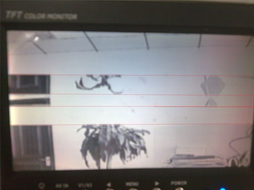

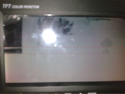

    I check my code carefully ,and I still can't solve the problem.Here I want to show you the picture i got:
    The part between the two red lines is unchanged .I add some rows to height/2,first 100,the part became taller,then changed to 50,a litter taller,I changed to 38,28,it seems no change on tall.
    I change my code like this:
    for(i=inArgs->height/3;i<inArgs->height/2;i++),the rest remains the same,I got the picture which has four red lines in it .It apprears that the middle part still unchanged.
    I wonder whether i can access the unchanged pixels data.Please help me solve the problem.Thanks.
  • OK, here are my thoughts...
    1) What is the size of the data structure you are accessing? Is it possible you are simply not 'flipping' enough data? The frame buffer pixel size is critical to the calculations.
    2) Try halting the process which is writing to memory and simply keep calling the 'flip' routing. If the flip does not correctly flip, then this is where the issue is and we can focus on that alone.
    3) Try using controlled data, e.g. write, say green pixels to the top part of the flip and blue to the bottom part. This will let you know if you are writing to the correct memory locations.
    4) Limit the region you are modifying to say 1 line on the middle of the screen and write a fixed color. Again this will help you understand whether you are really changing the picture in the place you really are expecting.
