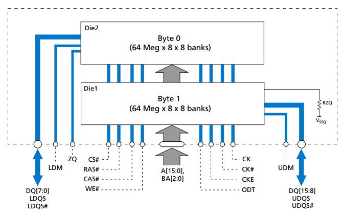

  • Hi Tom,
    This is the functional block of the twin-die device, there is only one set control pins, so it is a single rank device, right?

  • Snaku,
    Understood.  I am not familiar with twin-die SDRAMs with that arrangement.  These have single loads on the data pins but two loads on all address, command, control and clock.  This is still a concern from the electrical load perspective although it should level same as a single rank topology using single die devices.  What is the SDRAM arrangement in your topology - i.e. how many SDRAMs of what density?

  • Snaku,
    As I said before, I am not familiar with this type of twin-die SDRAM.  However, since the memory rank of SDRAM will look like 8 individual SDRAM chips on a single chip select, it should level and operate at the rated speeds.  This topology will have 2 Address, Command, Control and Clock loads per SDRAM pin and only a single load on each data pin.  It should look electrically same as if you implemented a single rank of 8 SDRAMs each in an x8 configuration.  Be sure to follow the guidance in the DDR3 interface commissioning wiki:
    Tom
  • Skaku,
    I just looked back at the original question.  You were asking whether the twin-die device could be dropped into an existing board that is already in production.  I believe this should drop in and operate without software change.  However, the electrical loading will be different with the twin-die SDRAM.  Therefore, there will be a difference in the signal integrity.  If your existing design followed all of our guidelines, I believe it will work robustly at the rated speed using these twin-die devices.  However, if your design has reduced margin, then the increase in the electrical loads may cause a problem.  You will need to get samples of these alternate devices and then re-qualify your design.  Alternately, you might want to find a different SDRAM in the same x16 configuration that you originally qualified.
