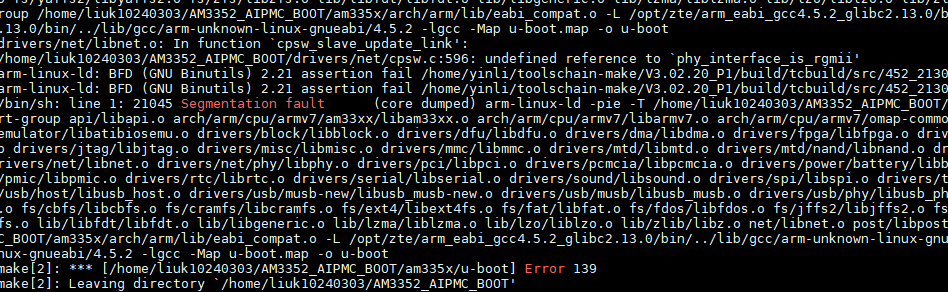

  • Thanks for the reply,
    I have a question ,  where is the definition of  the function  phy_interface_is_rgmii() , I have added the code but Compiled failed  , as follow
  • Hi , Schuyler
    I have added follow codes ,
    #if 1
    static int phy_interface_is_rgmii(struct phy_device *phydev)
    return phydev->interface <= PHY_INTERFACE_MODE_RGMII_TXID;

    Finally , it works
