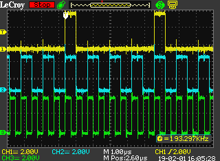

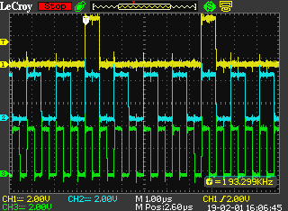

I have custom board and use SDK RTOS 05.02.00.10.

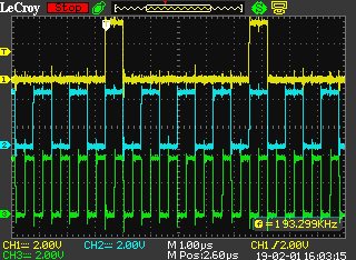

I successful run McBSP PDK example on my board but I can't set data delay on TX. When I modify dataDelay in mcbspChanConfigTx it's not influence to output on pins.

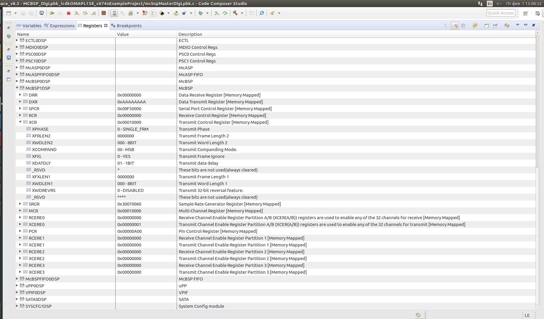

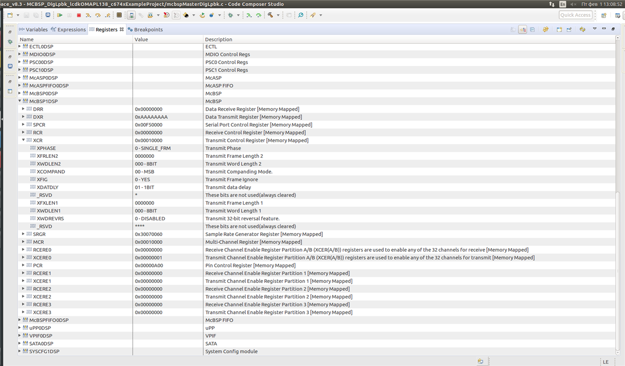

I checked McBSP registers. It seems like correct.

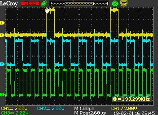

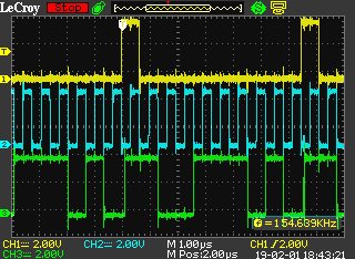

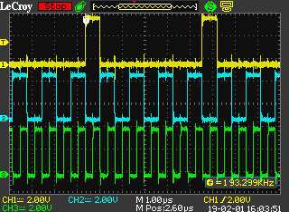

See signals on the pins FSX1, CLKX1, DX1 in attached pictures below.
Number of TX data bits remains constant regardless XDATDLY bits in XCR register.
My modified McBSP example code:

Thanks for any help!
Petr
