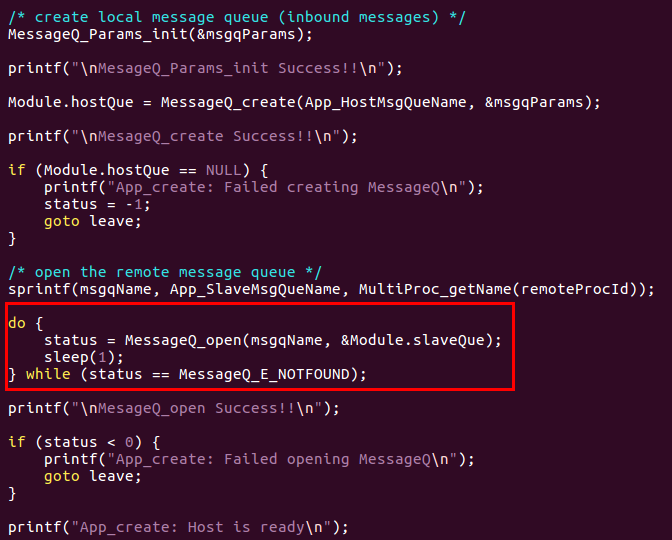

    I add some printf in the App_create () [ host_linux/simple_buffer_example/host/App.c ]
    After run ./app_host DSP2, I got the following messages:
    root@embest-am57xx:~/dsp# ./app_host DSP2
    --> main:
    --> Main_main:
    --> App_create:
    MesageQ_Params_init Success!!
    MesageQ_create Success!!
    It seems that it crashed in the MessageQ_Open.
    Best Regards
    Ricardo
  • Hi Ricardo,
    Can you confirm you are modifying the resource table in ~/example-applications/big-data-ipc-demo-linux-01.01.00.00/host_linux/simple_buffer_example/shared/DRA7XX?
    Looking at the resource table further, you may need to change DSP_MEM_IPC_VRING to 0x99000000. Can you please try that?
    Sahin
