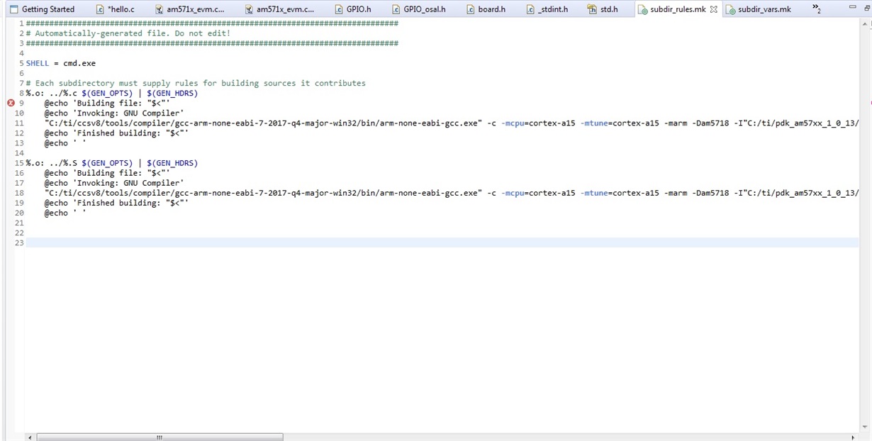

subdir_rules.mk  shows an error like these..

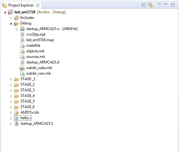

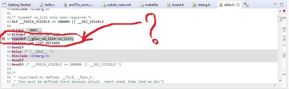

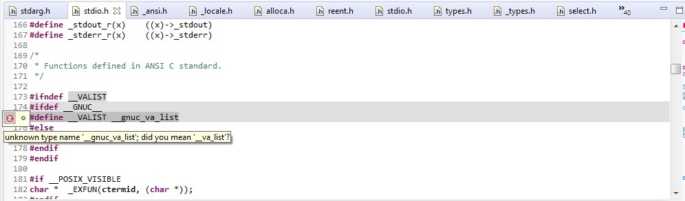

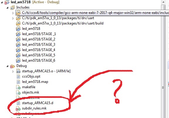

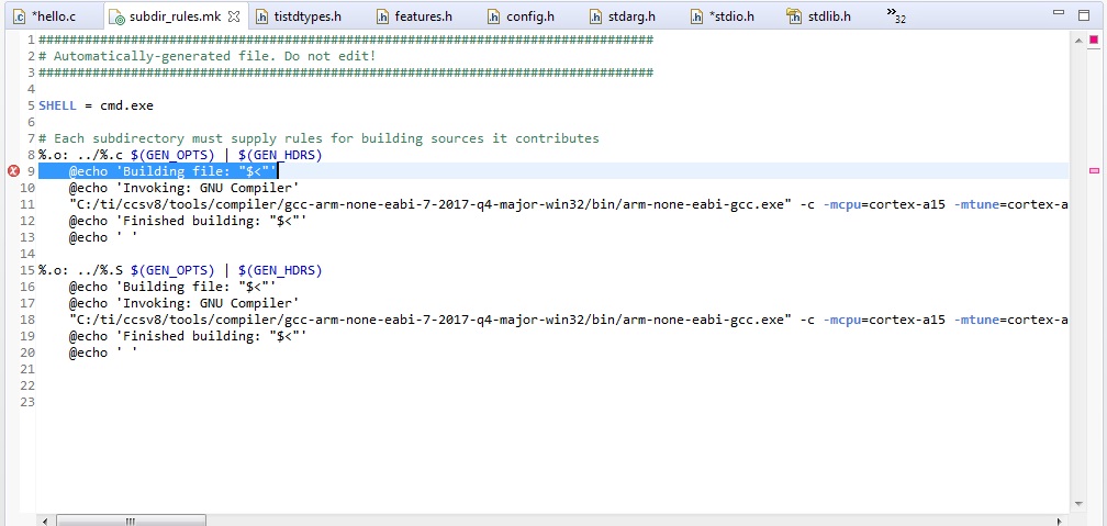

    Yes I'm trying to run GPIO bare metal application on the cortex AM571X IDK. I just added GPIO  functionality on the top of "hello world" as per you mentioned earlier.But during bulid time it shows 2 errors.
    1.error  inside the automatically generated file named sub_dir.mk as shown below.
    2.error (unknown type name) that points to the disabled part of code as shown below.
    same errors  happened in the case of McASP bare metal code.What is the reason for this errors.How we resolve these errors??..
