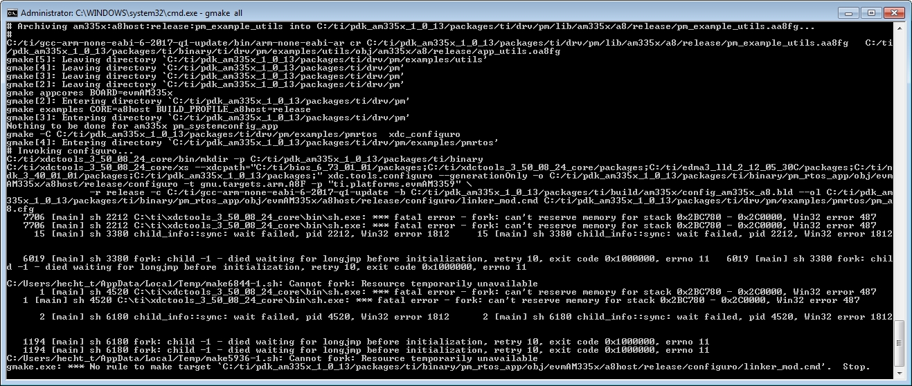

Hello , I am just about to complete the video "Demonstration DDR-less EtherCAT Slave on AMIC110". At the point gmake all I get after a while the following error message:
have you got an idea to get rid of it?

  • Thomas,
    Can you check if this helps? e2e.ti.com/.../624493
    Garrett

  • Thomas,
    The issue should be caused by incompatible cygwin (msys) or MinGW instead of missing libraries from TI. If you have these tools installed, can you try to uninstall it or reinstall as the thread suggested - e2e.ti.com/.../475176
    Garrett
  • Hi Garrett,
    I just found a spot on my machine where CygWin is, it comes with a Vivado installation from Xilinx, but I need it for my projects.
    If I follow the suggestion to delete for CygWin, I find on my computer no running Cygwin applications and also no entries in the regedit.
    I once tried to rename the directory, restart the computer and run gmake again - unfortunately again with the error message.
    Can it be due to MinGw? These are very common on my computer (Matlab2017, Vivado, ...) Can I find out which of the MinGw is used (for example, where)?
    best regards
    Thomas
  • pdksetupenv.zipI had previously discovered that you have to open a cmd shell. Then call there the batch "pdksetupenv.bat" so that gmake is known. So I deleted all environment variables, then I set the relevant ones again.
    This can now call the gmake error-free. With this procedure, I do not have to change / reinstall my computer.
