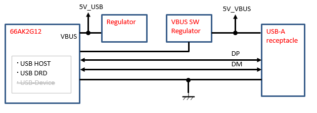

My customer is designing their custom board and now have some question about USB connection in HOST and DualRole.
As for the typical connection, they have referred the following document :
But rather than the suggestions described in the document, they are wondering if they could go with the following scheme:
Here, 5V_USB is powered by local 5V regulator and 5V_VBUS (for external device) is powered by another and specific regulator. Could you comment if that is still allowed in design ?
NK
  • Hi Naoki Kawada-san,
    Unless you have a good reason, please do route VBUS to VBUS-sense. That way USB controller and driver "will know" for possible failed VBUS.
    On your diagram, you are tricking the controller that 5-V are always present , which is the normal condition for USB host, so the controller *might* work. Again this is not recommended and I cannot say this is ok in all cases.
    Also, please note that with USB-A connector, controller may work in USB host only. DRD is not possible.
    Stan
    As suggested by Stan, if you use VBUS-sense, then you can use DRVVBUS pin of K2G to enable the regulator, instead of from a GPIO(assuming the line going from K2G to VBUS SW regulator is enable)
    I confirm that the recommended connection of the USB is described in the Schematic Checklist). If you choose to go with a design that is different you will have limited support in the future.
    Yordan
