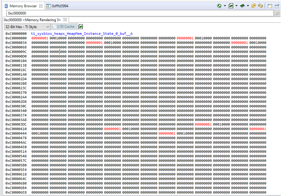

We development a custom board with OMAP-L138. In the board we put DDR2 memory MT47H128M16RT-25E:C from Micron.
We initialize the DDR in the GEL file according to the datasheet and similarly to the LCDKOMAPL138 board. We succeed to read and write to the memory, but the problem that we facing is that when we write to a single cell in the DDR, multiply cells are changing to the value that we wrote, those cells are not random and have the same offset every time.
In the picture we try to wrote '1' to the first cell but multiply cells has change (appearing in red).

Any suggestion to what can cause this problem?
