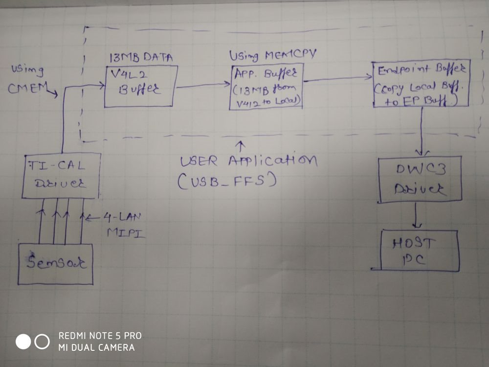

Dear All,
Right now we are facing the issue of fps and which is the bottleneck of our End Application/Project.
Could you please suggest any way in-which we can directly transfer camera image to usb with 150MBPS [12fps for 13MP]?
