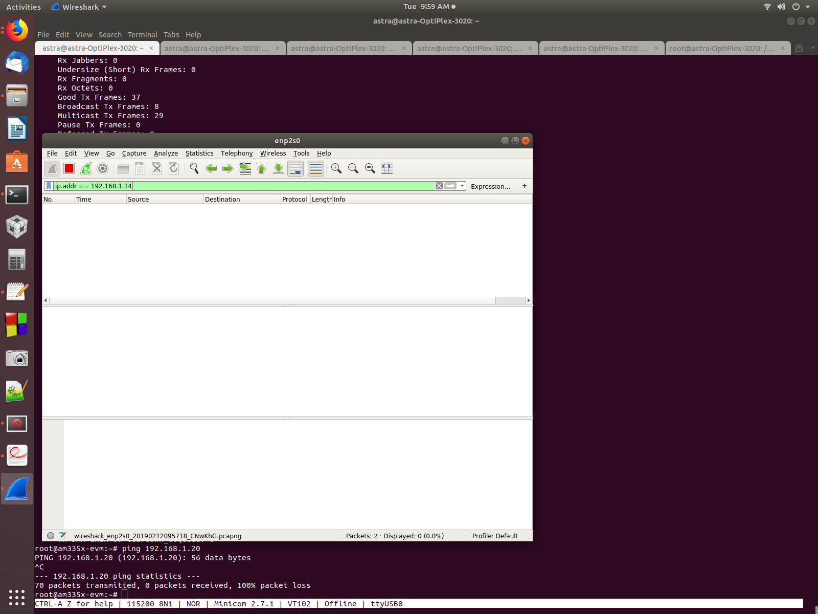

Hi Team,
can  MII1_REFCLK can be used as GPIO in RGMII mode?
i am able to see 50 MHz clock on this pin, if iam trying to use MII1_REFCLK as GPIO my Ethernet PING is failing
please let me know how to use MII1_REFCLK as GPIO in RGMII mode
Sandeep.M
    Seeing 50MHz on this pin in RGMII mode means you have something wrong in the Ethernet configuration. RMII1_REFCLK is used only as input in RMII mode. Please complete this checklist and post the results here: processors.wiki.ti.com/.../5x_CPSW
  • Hi Biser,
             These are the checklist results:
             1)  Kernel version :Linux am335x-evm 4.14.67-gd315a9bb00 #11 PREEMPT Sat Feb 2 17:32:16 IST 2019 armv7l GNU/Linux
             2)Filesystem:arago-base-tisdk-image-am335x-evm.ubi
             3)Custom board based on am3359 icev2,dts

    If we un-comment the gpio part in the DTS file. The reference clk is disables and the GPIO works as intended, but we end up with the Ethernet connection not working (Unable to Ping the HOST).
    This is the Reg value for the PINMUX after enabling GPIO :
    root@am335x-evm:~# devmem2 0x44E10944
    /dev/mem opened.
    Memory mapped at address 0xb6f1b000.
    Read at address  0x44E10944 (0xb6f1b944): 0x0000002F

    I will suggest that you use wireshark to look at and verify the packets coming out of the interface. You want to see the ARP packets come out looking for the ip address that you are trying to ping.

    Is there a way to capture the network traffic from the 192.168.1.20 address in your example?
    You will need to verify that you have a link detected with a link partner and prove arp packets are being transmitted.
    Schuyler

    Host PC wireshark screenshot:

    Thanks for posting the logs, the wireshark capture and especially the PC interface statistics. This helps by seeing what the link partners are seeing. Can I assume that the two link partners are directly connected?
    It looks like to me like the data receive interactions with the Ethernet PHY needs to be investigated and why changing the gpio causes this issue. The TI part at the lowest level as captured in the MAC interface statistics is sending out packets. This can only happen if the driver sees a link partner which it does and that is being reported by the ethtool which is indicating a link is detected. Looking at the PC statistics shows that it is receiving packets, roughly the same as what was sent by the TI part. Now looking back at the TI part on the receive side at the MAC level statistics there are not any packets being received. I recommend changing the filter on the wireshark to show all traffic and then look for the ARP traffic between the two link partners. I suspect that the ARP process is not completing and therefore the ICMP packets are not happening.
    As far as a next step I would recommend hooking up a scope to watch the out bound traffic on the MAC to PHY data path. Also verify looking at the PHY datasheet where and what the expected clocks should be on the receive path.
    You might also try changing out the GPIO again to see the expected traffic on wireshark so you have an idea of what that looks like.
    Schuyler
