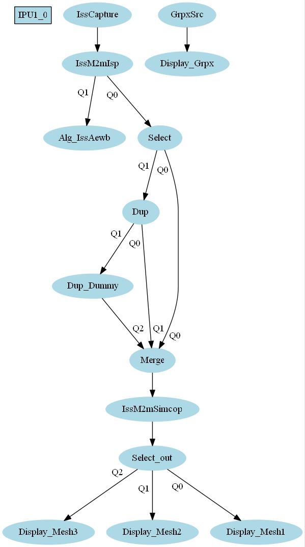

Hello Experts,
I created a usecase (see related post or attached image) that looks like this:
  • capture frames from 2 cameras/channels
  • processing in ISP (2 channels)
  • duplicate one channel with dup link (-> total of 3 channels)
  • processing in SIMCOP (3 channels)
  • merging with DMA_SWMS link
  • output
Inputs are 1080p@60fps. ISP runs in Linear Mode. The SIMCOP does LDC and internally crops the frames to fit on one 1080p frame. I am running this usecase on a custom TDA2P board and I use PSDK 3.5. Also I set the OPP mode to PLUS/HIGH already.
Even though the Statistics Display (on screen graphic) shows that the ISP load is approx. 60%, the UART statistics show that the ISP link drops about 10 fps. Is the ISP not able to handle two 1080p channels at 60fps? I attached my statistics as well, maybe you find the error there..
Tobias
[IPU1-0]   5108.084792 s:  [ ISSCAPTURE ] Link Statistics,
[IPU1-0]   5108.084883 s:  ******************************
[IPU1-0]   5108.084975 s:
[IPU1-0]   5108.085097 s:  Elapsed time       = 115198 msec
[IPU1-0]   5108.085371 s:
[IPU1-0]   5108.085432 s:  Get Full Buf Cb    = 120.12 fps
[IPU1-0]   5108.085554 s:  Put Empty Buf Cb   = 120.12 fps
[IPU1-0]   5108.085646 s:  Driver/Notify Cb   = 120.13 fps
[IPU1-0]   5108.085737 s:
[IPU1-0]   5108.085798 s:  Input Statistics,
[IPU1-0]   5108.085859 s:
[IPU1-0]   5108.085920 s:  CH | In Recv | In Drop | In User Drop | In Process
[IPU1-0]   5108.086073 s:     | FPS     | FPS     | FPS          | FPS
[IPU1-0]   5108.086195 s:  --------------------------------------------------
[IPU1-0]   5108.086317 s:   0 |  60. 6      0. 0      0. 0          60. 6
[IPU1-0]   5108.086469 s:   1 |  60. 6      0. 0      0. 0          60. 6
[IPU1-0]   5108.086591 s:
[IPU1-0]   5108.086652 s:  Output Statistics,
[IPU1-0]   5108.086713 s:
[IPU1-0]   5108.086744 s:  CH | Out | Out     | Out Drop | Out User Drop
[IPU1-0]   5108.086835 s:     | ID  | FPS     | FPS      | FPS
[IPU1-0]   5108.086896 s:  ---------------------------------------------
[IPU1-0]   5108.086988 s:   0 |  0     60. 6     0. 0      0. 0
[IPU1-0]   5108.087140 s:   1 |  0     60. 6     0. 0      0. 0
[IPU1-0]   5108.093180 s:
[IPU1-0]   5108.093271 s:  [ ISSM2MISP ] Link Statistics,
[IPU1-0]   5108.093363 s:  ******************************
[IPU1-0]   5108.093454 s:
[IPU1-0]   5108.093515 s:  Elapsed time       = 115203 msec
[IPU1-0]   5108.093607 s:
[IPU1-0]   5108.093668 s:  New data Recv      = 120.11 fps
[IPU1-0]   5108.093759 s:  Get Full Buf Cb    = 182.58 fps
[IPU1-0]   5108.093851 s:  Driver/Notify Cb   = 100.37 fps
[IPU1-0]   5108.093973 s:
[IPU1-0]   5108.094003 s:  Input Statistics,
[IPU1-0]   5108.094125 s:
[IPU1-0]   5108.094186 s:  CH | In Recv | In Drop | In User Drop | In Process
[IPU1-0]   5108.094278 s:     | FPS     | FPS     | FPS          | FPS
[IPU1-0]   5108.094400 s:  --------------------------------------------------
[IPU1-0]   5108.094522 s:   0 |  60. 5      9.86      0. 0          50.18
[IPU1-0]   5108.094705 s:   1 |  60. 5      9.86      0. 0          50.18
[IPU1-0]   5108.094857 s:
[IPU1-0]   5108.094888 s:  Output Statistics,
[IPU1-0]   5108.094949 s:
[IPU1-0]   5108.094979 s:  CH | Out | Out     | Out Drop | Out User Drop
[IPU1-0]   5108.095101 s:     | ID  | FPS     | FPS      | FPS
[IPU1-0]   5108.095162 s:  ---------------------------------------------
[IPU1-0]   5108.095254 s:   0 |  0     50.18     9.86      0. 0
[IPU1-0]   5108.095376 s:   0 |  1     50.18     9.86      0. 0
[IPU1-0]   5108.095498 s:   0 |  2      0. 0    60. 5      0. 0
[IPU1-0]   5108.095620 s:   0 |  3      0. 0    60. 5      0. 0

  • Hi Tobias,
    From the statistics, ISP takes around 4.9ms for processing a frame, which means it can process 2 channels of 1080p streams, without any issue. It does not look like frame drop is because of ISP processing.. All other down stream modules seems to be running in real time for 2 channels, AEWB = 4.4ms, Simcop 6.5ms, sync link=7.8ms.
    I think it might be dropping because of less number of output buffers. The default number of output buffers in ISP is just 2. Could you please check if you are using default number of output buffers? Can you try increasing number of output buffers?
    Also one thing missing in the stats is CPU load.. how is IPU loaded? could you please check if it is not heavily loaded?
    Rgds,
    Brijesh
  • Hi Brijesh,
    I looked at some other usecases and set the number of ISP buffers to 4 and SIMCOP buffers to 6. I also tried to increase these numbers even further but that didn't bring any improvement. IPU1 load is just around 52%.
    Tobias
  • Hi Tobias,
    Could you please share the sync parameters, threshold and delta?
    If they are set to high value, it might be possible that these buffers are held in the sync link.
    Brijesh
  • Hi Brijesh,
    pPrm->syncDelta = 0x7FFFFFFF;
    pPrm->syncThreshold = 0x7FFFFFFF;
    They're indeed set pretty high.. do you know any suitable values for my 60 fps chain?
    Tobias
  • Hi Tobias,
    In this case, syncDelta should be set to 17ms and syncThreshold to 34ms.
    Since you have two camera input at 60fps, two frames from the two cameras can be at max 17ms apart, which is what the syncDelta used for, it synchronizes frames whose time stamp difference is within syncDelta limit.
    Sync Threshold is used when time stamp difference is more than syncDelta. In this case, this tell how long this frame should be kept with the sync link. If it goes beyond that syncThreshold, it will be returned to the previous link.. I think frame time period * 2 should be sufficient for syncThreshold, which is 34ms in your case..
    Rgds,
    Brijesh
  • Hi Brijesh,
    I tried your values but ISP link still drops around 8 fps. Additionally SYNC link now drops around 18 fps which result in a total frame rate of 34. Does that mean one link cant handle some frames in real time? Maybe SIMCOP, because in the statistics there was a "Max" local latency of 15,3 ms?
    Also Sync link comapares the srcTimestamp values of each frame. But the one duplicated frame (via dup link) gets the same srcTimestamp assigned like its origin frame, doesn't it? So we cant really compare the three timestamps, because two of them are always the same..?
    Tobias
  • Hi Tobias,
    Which means, some one is blocking/holding the the frames for more than 34ms..
    Yes, it could be simcop if you have enabled LDC, as LDC table is not tuned for the 2MP camera..
    For the time being, can you please remove the simcop from the chains and see if it works real time?
    I see min time for simcop is 6.5ms, so for two channels, it should be able to finish in 13ms.. So there is still bit head room for scheduling.. But we are seeing max time as 16.5ms, it should not be so high, may be task is not getting chance to run.. we can bump up the priority of simcop task, but lets first see if it works without simcop..
    Even if you have dupped the frame, it would have same time stamp and since the difference is 0, which is lower than 16ms, it would try to synchronize them.. There should not be any problem because of dup..
    We kept sync delta to 17ms, because out of three inputs, two are real asynchronous inputs.
    Brijesh
  • Hi Brijesh,
    Simcop actually hast to run three times in our usecase. We got three different mesh tables from our customer and all of them have to be applied to one channel each, so three in total.
    I also removed the Simcop link as you suggested. Now only the SWMS link drops about 0.5 fps. The rest of the chain runs at approx. 60 fps (see attached statistics). So Simcop is the weak link here. That also makes sense because it has to process the most data since ISP just has to process two 1080p frames (Dup happens after ISP but before Simcop).
    We also tried to remove the SWMS link and change the layout of the usecase (see attached picture). This way we reduced the frame drops to 6.8 fps. Maybe we can get even nearer to 60 fps...
    1. Is it technically possible for the Simcop to process three 1080p frames @ 60fps?
    2. Where can I increase the Simcop task priority as you mentioned?
    3. Do you have any more tips how we could bring the usecase closer to 60 fps?
    Tobias

    New usecase layout we tried:
  • Tobias,
    Well, which TDA part that you are using?
    On TDA3x, it is not possible to process 2MP 3Ch @60fps.. This requires close to 400MHz pixel rate.. This is just too high.
    Now i know why we were seeing 6.5ms as average time and 3.5 as min time in simcop. Since you are three loopup table, it is varying..
    Can you please first check all three loopup table in standalone example or in simple single channel example and check the processing time required?
    Brijesh
  • Hi Brijesh,
    I'm using a TDA2P on a custom board. Is a TDA2P generally able to handle 3CH@60fps?
    The three tables also generate different sized output images but all use 1080p frames as an input. The sizes of the output areas are:
    - 1408 x 696
    - 1408 x 384
    - 512 x 1080
    I'm guessing the first table takes the longest time to be processed since its the largest, but I can check them individually.
    Tobias
  • Hi Tobias,
    It might possible in opp_high..
    output resolution is smaller, but it also depends on the look up table..
    so better to check them individually first.
    Brijesh
  • Hi Brijesh,
    I changed the usecase so that it is
    IssCapture -> IssM2mIsp -> IssM2mSimcop -> Display
    and measured the SIMCOP latencies of the individual channels/tables:
    CH0 (1408x696): Avg = 5366 us, Min = 5215 us, Max = 6740 us
    CH1 (1408x384): Avg = 4339 us, Min = 4239 us, Max = 4576 us
    CH2 (512x1080): Avg = 4594 us, Min = 4544 us, Max = 4728 us
    Tobias
  • Hi Tobias,
    If we add all max values, it comes very close to 16ms, which is very tight to run 60fps..
    May be you could try running in opp_high..
    Brijesh
  • Hi Brijesh,
    I'm already running in opp_plus. The latency values were also taken while in opp_plus.. So I'm already at max. settings here.
    You mentioned increasing the simcop task priority.. maybe this would help?
    Tobias
  • Hi Tobias,
    Can you try with the changes, i suggested at below link?
    e2e.ti.com/.../2847509
    Brijesh
  • Hi Brijesh,
    I changed the M2 divider to 1 and I also had to change the ISS_CLK_MUX register to 0x0. It was set to 0x3 at default and so DPLL_CORE clock is chosen as the reference clock for the ISS. Now it should take EVE3_GFCLK/2 as a reference..
    After that I also noticed a change in the ISP load (Graphics Display) and the frame drops went down to just 0.5 fps per channel.
    One thing I was wondering: In data sheets it is stated that 532 MHz is the max. frequency for ISS/ISP. We now increase it to (20 x 260 / 4) / 2 = 650 Mhz. Is it safe to increase the ISS frequency?
    Tobias
  • Tobias,
    No, it is not recommended to use frequency, higher than mentioned in TRM.
    Brijesh
  • Hi Brijesh,
    Understood. Do you have any other ideas on how I could remove those last frame drops?
    Also I notived something strange. When I set the OPP mode back to OPP_NOM the drops went actually down compared to OPP_HIGH (without any manual frequency changes). On HIGH, drops were about 7 fps per channel, on NOM they're only about 2 fps..
    Tobias
  • Tobias,
    You could try changing ISSM2MSIMCOP_LINK_TSK_PRI task priority in links_fw\src\rtos\links_common\system\system_priv_common.h file.
    This is surprising. Are you sure opp value is the only change between two runs?
    Rgds,
    Brijesh
  • Hi Brijesh,
    I increased the priority but it I just noticed a small increase in fps (like 1-2). And the only thing I changed between two runs was the gel file entry that specified the OPP mode config that should be used.. That seemed also strange to me.
    Anyway, I managed to decrease the frame drops by adjusting our LDC parameters i.e. increasing OutputBlockWidth and OutputBlockHeight of LDC. They were set to small values which apparently made SIMCOP processing quite long.. I am now to 59.7 fps in total and SIMCOP only drops about 0.5 frames.
    Tobias
  • Hi Tobias,
    That's good. Yes, output block size and pixel pad can reduce the LDC processing time and can improve overall throughput.
    You could run this lookup table in DCC tool and get the optimal block size..
    Rgds,
    Brijesh
