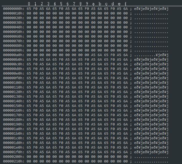

Hey,
I have a keras model that I imported to TIDL. Importing seems to have worked fine.
The model basically just takes an .png input file and classifies the picture in 0 and 1.
Now when I run the model in host emulation mode (eve_test_dl_algo.out.exe) and read the quat_stats_tool for generated output I get the following results for the images (Image_*_Class_* is the name of the image and what class it is supposed to be classified to):
Image_0_Class_0 = FE 00
Image_1_Class_0 = FE 00
Image_2_Class_0 = FE 00
....... Output for images of class 0 is always the same.
Image_0_Class_1 = C7 37
Image_1_Class_1 = 07 F7
Image_2_Class_1 = 1E E0
Image_3_Class_1 = E9 15
etc. so for images of class 1 tjhe results is different most of the time but with the sum of first Hex and second Hex always resulting to FE.
Somehow this tells me the model is working in a way, since it´s able to make a classification, but the numbers don´t really make sense to me.
I added a .txt file that contains the output of the console when runing the eve_test_dl_algo_out.exe
Do you have an idea on how to interprete those number?
thank you
Nico

  • Since your last layer is softmax with the output size of two, what you get as output is the probability of two classes 0 and 1.
    Since, softmax output is converted to 8-bit fixed point number. if you need floating point output, you can run till last global pooling in TILD and run the softmax of two outside TIDL in floating point.
  • Yes that´s what I thought but I am wondering why for the second class the probabilities oftenly are higher for class 0 than their actual class, when in the keras model the probability fits really good to the actual class of the image. Does this mean the model does not work very well on the ti platform as a result of the translation?
    Another question is when I load more images the output in stats_tool_out is only the result of the last image put into the model?
    For example if I load 4 images with the results:
    image_0 = FE 00
    image_1 = FE 00
    image_2 = FD 01
    image_3 = 00 FE
    00 FE 00 FE 00 FE 00 FE
    Why is that?
    thank you,
    nico
  • Refer user guide section, matching with reference for the first question
    The output from each image  will be appended in the file two bytes for each input.  When you run individually and as a sequence, the output could be different. We have dynamic quantization implemented which uses statistics from inference executions.
  • So for now I am okay with the above mentioned results when running the inference with inputfile being a png file.

    So I guess I just want to print the output of the softmax layer to the file, but I can´t find that softmax output in the code.
  • Output file szie soupposed to be sameas the last tensor size in your network.
    The use case code do not perform any computation
  • hm, okay but when I run the host emulation on pc the output in quant_stats_tool is as expected (00 FF), how do I get this output for the usecase?

  • Hey Anuj,
    I made some progress.
    After using the src release of TIDL I was able to debug the tidl_softmax.c file. There is an output variable that holds the correct probabilities for my classes.
    So my next aim is to get camera capture as input for tidl I/O usecase.
    I can train my model to yuv and then us the yuv image as input for tidl.
    TIDL then runs inference and returns a classification.
    So far my idea is to have nullsrc for net files, like cfg and params and model.
    Then I have isscapture->isp where it is transformed to yuv, then I use dup link to send that image to vpe, where I resize it to my needed size and then put it to algorithm link where tidl is supposed to run.
    Parrallel the output of isp is send to display link where I just display the normal camera frames.
    Do you think this is possible?
    thank you
    nico
  • hey
    any updates?
  • use vision SDK as the test bench where we do have file read, TIDL and display usecase is there. This file read (nullSrc) can be replaced with camera capture if you can capture YUV420SP video and then resize to desired resolution, reuse the remaining TIDL chain as is.
    Regards, Shiju
  • Yes I already made this work.
    Do you mean by use the tidl as is, that I also use tidl_preproc algorithm? If possible I´d like to leave that out and go directly from ISP (YUV) into tidl_algorithm.
    I read somewhere, that tidl needs bgr input, but is that only for your examples or does tidl only work with bgr input in general?
  • Yes, TIDL ALg need input video in BGR format
    regards, Shiju
