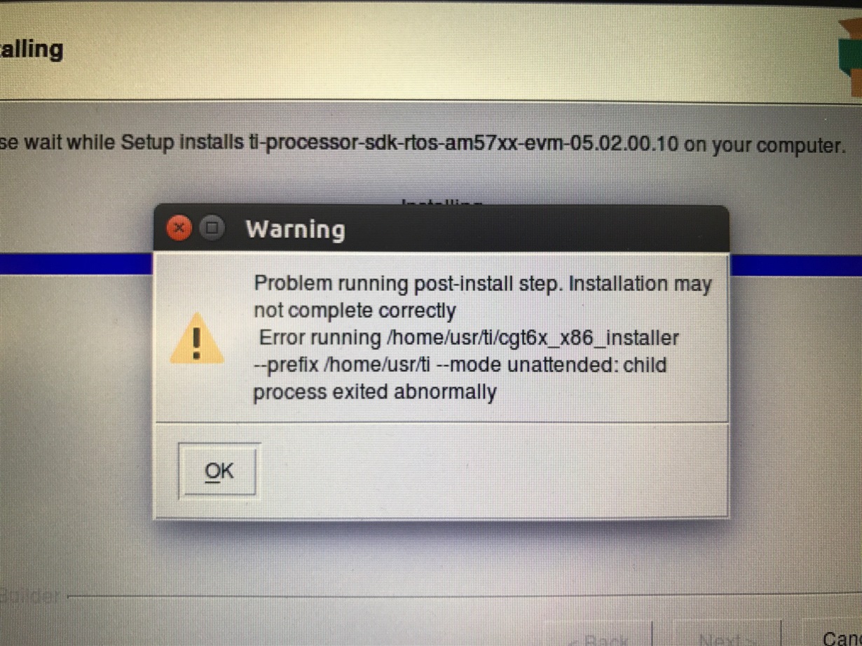

Hello, TI Experts,
We have a question about "ti-processor-sdk-rtos-am57xx-evm-05.02.00.10-Linux-x86-Install.bin" of PROCESSOR-SDK-RTOS-AM57X 05_02_00_10.
We failed this SDK install by the below Error with ubuntu16.04.
We also failed this SDK install by the same Error with ubuntu14.04.
Question:
     Do you have same experience?
We want to run IPC sample on Linux based on the below link.
http://software-dl.ti.com/processor-sdk-linux/esd/docs/05_01_00_11/linux/Foundational_Components_IPC.html
We would appreciate if you tell us how to solve this problem.

    I have Ubuntu 16.04 LTS 64-bit, and I am able to install ti-processor-sdk-rtos-am57xx-evm-05.02.00.10-Linux-x86-Install.bin successful.
    You need to verify that you have 64-bit version of Ubuntu.
    See also below pointers which explains how to install RTOS:
    software-dl.ti.com/.../index_overview.html
    Pavel

    Yes.
    I used 64-bit version of Ubuntu.
    I tried to ignore this warning and continue to install.
    But I cannot find some folders such as "ti-cgt-arm_xxxx folder" like below.
    Question:
     Do you see "ti-cgt-arm_xxxx folder" after installing ti-processor-sdk-rtos-am57xx-evm-05.02.00.10-Linux-x86-Install.bin?

    Yes, I have this folder. See below what I have after successful installation:

    During installation, you should have option to select which components to install. Make sure you select all the components.

    It seems to be success of the SDK installation after CCS installed.
