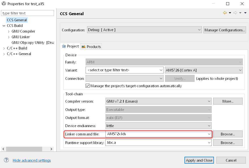

Hello, I have a question.
In evmAM 572x, I am trying to create an SBK file according to the following site.
processors.wiki.ti.com/.../Creating_a_CCS_Project_for_SBL_on_AM572x_GP_EVM
In CCS build, Then I get the following error
Description Resource Path Location Type
com.out section `.stack' will not fit in region `SBL_MEM' com C/C++ Problem
gmake: *** [all] Error 2 com C/C++ Problem
gmake[1]: *** [com.out] Error 1 com C/C++ Problem
recipe for target 'all' failed makefile /com/Debug line 160 C/C++ Problem
recipe for target 'com.out' failed makefile /com/Debug line 164 C/C++ Problem
region `SBL_MEM' overflowed by 17225 bytes com C/C++ Problem
section SBL_MMU_TABLE VMA [40370000,4037404b] overlaps section .stack VMA [40354348,40374347] com C/C++ Problem
redeclaration of memory region `DDR0' .ccsproject /com line 44, external location: c:\ti\ccsv8\tools\compiler\gcc-arm-none-eabi-7-2017-q4-major-win32\arm-none-eabi\bin\ld.exe:C:\ti\pdk_am57xx_1_0_13\packages\ti\boot\sbl\board\evmAM572x\build\linker.cmd C/C++ Problem
redeclaration of memory region `OCMC_RAM1' .ccsproject /com line 45, external location: c:\ti\ccsv8\tools\compiler\gcc-arm-none-eabi-7-2017-q4-major-win32\arm-none-eabi\bin\ld.exe:C:\ti\pdk_am57xx_1_0_13\packages\ti\boot\sbl\board\evmAM572x\build\linker.cmd C/C++ Problem
redeclaration of memory region `OCMC_RAM2' .ccsproject /com line 50, external location: c:\ti\ccsv8\tools\compiler\gcc-arm-none-eabi-7-2017-q4-major-win32\arm-none-eabi\bin\ld.exe:C:\ti\pdk_am57xx_1_0_13\packages\ti\boot\sbl\board\evmAM572x\build\linker.cmd C/C++ Problem
redeclaration of memory region `OCMC_RAM3' .ccsproject /com line 51, external location: c:\ti\ccsv8\tools\compiler\gcc-arm-none-eabi-7-2017-q4-major-win32\arm-none-eabi\bin\ld.exe:C:\ti\pdk_am57xx_1_0_13\packages\ti\boot\sbl\board\evmAM572x\build\linker.cmd C/C++ Problem
The memory seems to overflow, but is the setting of Linker file correct?

  • The default way to build the SBL is using the makefile approach. Can you indicate why you want to build the SBL by creating a CCS project from the source?
    There are two issues that I have observed from limited log that you have shared:
    1. We are supporting AM572x SDK with GCC compiler 6.x which is provided in the installer but your project seems to be using GGC7.x .
    2. The other issue seems to be when you are creating CCS project you seem to be including the linker command file from CCS package and also using the linker command file from the SBL folder. This likely causes the Memory section re-declaration issues.
    I would recommend that you build the SBL using makefile first and capture the command line log and then compare with the CCS build log to make sure there are no differences.
    To build the SBL using make file follow the instructions below:

  • 1.You need to do a clean build of the SBL to see the build. It appears the object files and executable is already created in the setup so the gmake doesn`t find anything to build. You also need to update the make file to echo the compilation and link setup to see full output of the compiler and linker flags and make sure all source files.
    2. Did you remove the AM572x.lds  file linked to the CCS project as I indicated in the previous post.  Please refer screenshot below:
    Change that to "None" and only use the linker command file from the SBL folder.
    Rahul
