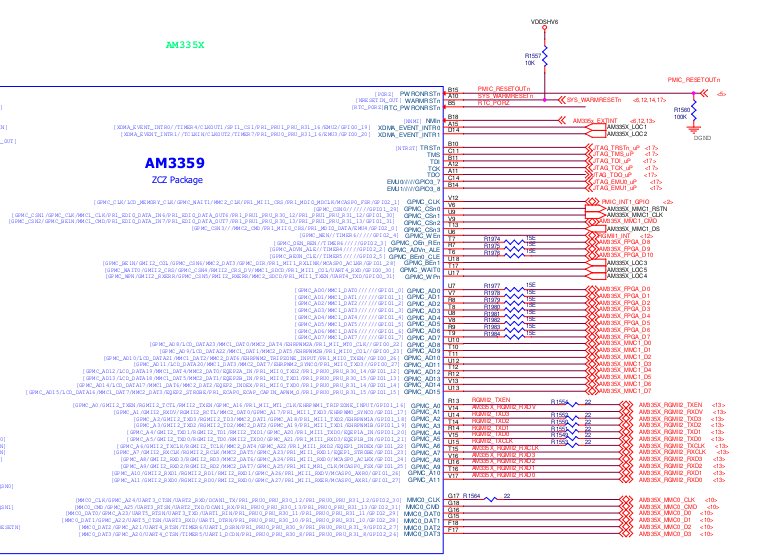

We are working on a board containing AM3359 processor.
SDK we are using is ti-processor-sdk-linux-am335x-evm-05.00.00.15.
Our customer wants to see the throughput of the data transfer between processor (AM3359) and FPGA connected through 8 GPMC lines using EDMA
As of now we've created a project in Code Composer Studio ( CCS ) with a GEL file and a C program & we are able to send data to FPGA through these 8 GPMC lines.
Right now we didn't insert any SD Card(i.e. Processor is not booted up).
Using JTAG & CCS only we did it.
Now we are not clear about how to proceed further in this regard on how to associate this gpmc program with EDMA protocol in Linux-SDK to send data to FPGA.
All we want now is to implement GPMC_EDMA data transfer program as per the below flow.
Processor booted ----> Run GPMC_EDMA Data transfer program ----> Complete data transfer ----> Calculate throughput.
Here is my code for transferring data to FPGA through 8 GPMC lines.

  • Can someone help me in modifying this attached dmatest.c
    This application is using threads and channels for transferring data within the processors memory.
    Now i want to modify it to send data to FPGA. I have a buffer containing numbers from 1 to 4096.
    When i run this dmatest using modprobe dmatest.... it should send data to FPGA and print the throughput.
    I am really tensed so much in making it happen for the last 3 weeks as we have so much pressure from our client. And also that I am new to kernel programming.

  • 1. I've added gpmc node and pinmux in dts.
    GPMC node:
    &gpmc
    pinctrl-names = "default";
    pinctrl-0 = <&gpmc_pins>;
    ti,pindir-d0-out-d1-in = <1>;
    status = "okay";
    nor@0,0 {
    compatible = "cfi-flash";
    //linux,mtd-name= "intel,pf48f6000m0y1be";
    #address-cells = <1>;
    #size-cells = <1>;
    reg = <0 0 0x08000000>;
    bank-width = <8>;
    gpmc,mux-add-data;
    gpmc,cs-on-ns = <0>;
    gpmc,cs-rd-off-ns = <10>;
    gpmc,cs-wr-off-ns = <6>;
    gpmc,adv-on-ns = <1>;
    gpmc,adv-rd-off-ns = <1>;
    gpmc,adv-wr-off-ns = <1>;
    gpmc,oe-on-ns = <3>;
    gpmc,oe-off-ns = <10>;
    gpmc,we-on-ns = <1>;
    gpmc,we-off-ns = <5>;
    gpmc,rd-cycle-ns = <9>;
    gpmc,wr-cycle-ns = <6>;
    gpmc,access-ns = <9>;
    gpmc,page-burst-access-ns = <1>;
    gpmc,bus-turnaround-ns = <12>;
    gpmc,cycle2cycle-delay-ns = <18>;
    gpmc,wr-data-mux-bus-ns = <90>;
    gpmc,wr-access-ns = <9>;
    gpmc,cycle2cycle-samecsen;
    gpmc,cycle2cycle-diffcsen;
    //partition@0 {
    // label = "bootloader-nor";
    // reg = <0 0x40000>;
    //partition@0x40000 {
    // label = "params-nor";
    // reg = <0x40000 0x40000>;
    //partition@0x80000 {
    // label = "kernel-nor";
    // reg = <0x80000 0x200000>;
    //partition@0x280000 {
    // label = "filesystem-nor";
    // reg = <0x240000 0x7d80000>;
    Pinmux:
    gpmc_pins: pinmux_gpmc_pins {
    pinctrl-single,pins = <
    AM33XX_IOPAD(0x800, PIN_INPUT_PULLUP | MUX_MODE0) /* gpmc_ad0.gpmc_ad0 */
    AM33XX_IOPAD(0x804, PIN_INPUT_PULLUP | MUX_MODE0) /* gpmc_ad1.gpmc_ad1 */
    AM33XX_IOPAD(0x808, PIN_INPUT_PULLUP | MUX_MODE0) /* gpmc_ad2.gpmc_ad2 */
    AM33XX_IOPAD(0x80c, PIN_INPUT_PULLUP | MUX_MODE0) /* gpmc_ad3.gpmc_ad3 */
    AM33XX_IOPAD(0x810, PIN_INPUT_PULLUP | MUX_MODE0) /* gpmc_ad4.gpmc_ad4 */
    AM33XX_IOPAD(0x814, PIN_INPUT_PULLUP | MUX_MODE0) /* gpmc_ad5.gpmc_ad5 */
    AM33XX_IOPAD(0x818, PIN_INPUT_PULLUP | MUX_MODE0) /* gpmc_ad6.gpmc_ad6 */
    AM33XX_IOPAD(0x81c, PIN_INPUT_PULLUP | MUX_MODE0) /* gpmc_ad7.gpmc_ad7 */
    AM33XX_IOPAD(0x894, PIN_OUTPUT_PULLUP | MUX_MODE0) /* gpmc_OEn_REn.gpmc_OEn_REn */
    AM33XX_IOPAD(0x890, PIN_OUTPUT_PULLUP | MUX_MODE0) /* gpmc_ADVn_ALE.gpmc_ADVn_ALE */
    AM33XX_IOPAD(0x89c, PIN_OUTPUT_PULLUP | MUX_MODE0) /* gpmc_BEn0_CLE.gpmc_BEn0_CLE */

  • I am happy to tell that, gpmc fpga data transferring is working fine. Following changes I made to make it work.
    1. gpmc-fpga pinmux added from
    e2e.ti.com/.../555762
    2. added to /linux-4.14.40+gitAUTOINC+4796173fc5-g4796173fc5/drivers/memoryomap-gpmc.c
    replaced the function:
    static void gpmc_cs_set_reserved(int cs, int reserved)
    struct gpmc_cs_data *gpmc = &gpmc_cs[cs];
    gpmc->flags |= GPMC_CS_RESERVED;
    with:
    if (reserved)
    else
    gpmc->flags &= ~GPMC_CS_RESERVED;
