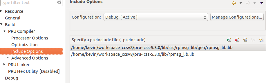

CCS/PROCESSOR-SDK-AM57X: CCSV8: when building the example CCS project on PRU RPMsg, failed, the reason is in the rpmsg_lib.lib of firmware
Part Number: PROCESSOR-SDK-AM57X
Other Parts Discussed in Thread: AM5728, AM4379,

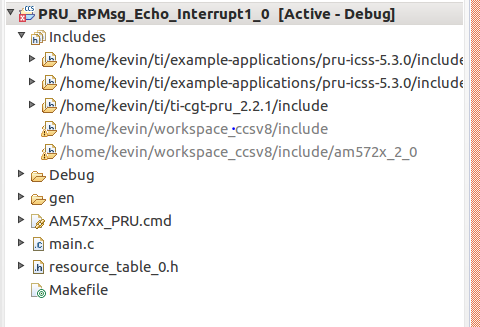

When building the example CCS project, failed, the reason is in the rpmsg_lib.lib.
It seems the version of firmware cannot compatible to CCS or PRU example.
the example project is as the below:
The compilation is as the below:
**** Build of configuration Debug for project PRU_RPMsg_Echo_Interrupt1_0 ****
/home/kevin/ti/ccsv8/utils/bin/gmake -k all
Building file: "../main.c"
Invoking: PRU Compiler
"/home/kevin/ti/ti-cgt-pru_2.2.1/bin/clpru" -v3 --preinclude="/home/kevin/workspace_ccsv8/pru-icss-5.3.0/lib/src/rpmsg_lib/gen/rpmsg_lib.lib" --include_path="/home/kevin/ti/ti-cgt-pru_2.2.1/include" --include_path="/home/kevin/ti/example-applications/pru-icss-5.3.0/include" --include_path="/home/kevin/ti/example-applications/pru-icss-5.3.0/include/am572x_1_1" --include_path="/home/kevin/workspace_ccsv8/include" --include_path="/home/kevin/workspace_ccsv8/include/am572x_2_0" -g --define=pru0 --define=am4379 --define=icss1 --define=am5728 --display_error_number --diag_warning=225 --diag_wrap=off --hardware_mac=on --endian=little --preproc_with_compile --preproc_dependency="main.d_raw"  "../main.c"
>> Compilation failure
subdir_rules.mk:7: recipe for target 'main.obj' failed
    The errors are because the PRU compiler is trying to compile the rpmsg_lib.lib as a source file, whereas the file is a library for use by the linker.
    The issue is that the rpmsg_lib.lib is specified on the --preinclude option to the compiler, specified on the CCS project properties CCS Build -> PRU Compiler -> Include Options.
    Whereas rpmsg_lib.lib should be specified on the --library option on the CCS project properties under CCS Build -> PRU Linker -> File Search Path.
    Which version of the PROCESSOR-SDK-AM57X are you using, and did you make any changes to the PRU_RPMsg_Echo_Interrupt1_0 example project after importing it into CCS?
  • yes, I specified it on the preinclude option..  I did not change the example project at all, I copy the ./pru-icss-5.3.0 from the directory of ./ti/example-applications/ into my CCS workspace.
    The question is, how can I config the Linker to link the rpmsg_lib.lib file?  thank you.
    how can I use the linker to build rpmsg_lib.lib?
  • thank you, I set the file using you suggestion. then it works.
