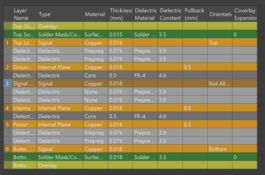

I have a board stack of 6 layers, some of which are fully filled planes (plane).
1. Tell me which plane (# 2 or # 4) in my situation is the reference for calculating the impedance for the conductors located on the inner layer (# 3)? And please explain why you think so.
2. Will the split plane, which is NOT a reference, affect the impedance of the adjacent layer?

    The layer on which the conductors are located whose impedance for me is the sequence number # 3. It is between layers # 2 and # 4, which both represent a plane completely flooded with copper (plane), but for example, connected to different signals (I wrote about this earlier “split plane)”. Plane # 2 is connected to GND, and on plane # 4 it is divided into zones and connected to 3V3, 5V, 12V power supply signals, etc. I am trying to understand whether both planes # 2 and # 4 for layer # 3 are reference points or only one of them? And what is the principle of defining the same supporting plane of these two, if both are simultaneously not supporting?
    P.S. Please look at the first column with sequence numbers, which highlighted the number # 3. The column "Name" can have any name and does not reflect the actual state of connection to this or that signal.

    Well, let's say I need to calculate the impedance of the differential pair (Differential Pair Signal Name: USB1 (USB1_P, USB1_N)) on layer # 3 (Zdiff 90 Ohm), before the GND signal (my voltage source), which is on both planes at the same time # 2 and # 4. (I change the conditions previously mentioned in the example). If I choose plane # 2 as the reference plane, will plane # 4 influence the impedance of layer # 3 because they both belong to GND. Indeed, in my layer stack, plane # 4 has a smaller distance to plane # 3 than plane # 2, as well as a lower dielectric constant?
    Main question:
    Is it possible that when calculating the impedance of USB conductors to GND, when selecting plane # 2 as the reference one, plane # 4 will have a greater effect on layer # 3, being also connected to GND as layer # 2?

    If you have the same GND plane spread on both plane # 2 and plane # 4 then based on how these GND zones are overlapping onto the USB signal traces on plane # 3, there will be a capacitance formed. With this I think both plane # 2 & 4 will have an impact on the impedance measurement done on plane # 3 USB signals. This definitely has to be considered into account while calculating the impedance of USB signals on plane # 3.
