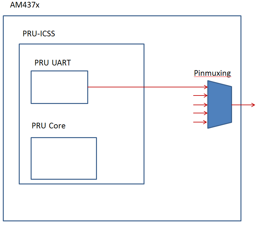

  • Hello Karthikeyan,
    PRU UART cannot be controlled from the ARM core by using the Linux UART driver. TI provides the PRU_Hardware_UART example in the PRU software support package as a demonstration of controlling the PRU UART with the PRU core.
    See the post PRU UART access from A15 for more information. See the post UART pins don't work with PRU for details on observing signals on the output pins by disabling the internal loopback used in that example.
    Nick
  • Hi Nick,
    Thanks for the reply, Is It configurable as per Ahmad_Rashed statment ?
    Please be more clear on what you mean by "it" and "Ahmad_Rashed's statement".
    If you mean "can I configure pinmuxing for either the PRU UART or for the UART9 according the Ahmad's instructions", then yes you can. However, that only configures the pinmux to allow signals from a certain part of the processor to reach the pins. It does not actually configure the UART or PRU UART to start sending output signals.
    If you are trying to use PRU UART, Ahmad's instructions will configure the pinmuxing. the code I pointed to will run on the PRU core, and the PRU core will configure the PRU UART and tell it to start sending signals to the output pins.
    I am replying with these assumptions. Please let me know if either of my assumptions are wrong.
    1) you want to control a hardware UART with the PRU core
    2) You have NOT demonstrated that the PRU can successfully control the hardware UART in the example TI provides
    REMOTEPROC
    RemoteProc is used to interface with multiple cores in the system - not just the PRUs. From your log on March 5, you can see that remoteproc0 & remoteproc1 are IPUs, remoteproc2 and remoteproc3 are DSPs, and remoteproc4 through remoteproc7 are PRU cores. If you are only trying to use the PRUs, you do not want to mess around with the IPUs or DSPs. Your command line output says that the PRUs are available to be used with RemoteProc, but it does NOT say that any firmware has been loaded into the PRU cores.
    LOADING PRU FIRMWARE
    Use the sysfs interface to load the PRU firmware and tell the PRUs to start running. See the RPMsg Quick Start Guide as an example. NOTE that you would want to load one of the 4 PRU cores, so according to your March 5 log you would NOT want to load remoteproc0.
    DEVICE TREE FOR USING PRU TO CONTROL HARDWARE UART:
    You should not need to make any changes to the PRU nodes in the device tree. Your PRUs are already set up so that Linux can use them. The device tree is there to tell Linux drivers how they should interact with different hardware. The PRU is going to be the core interacting with the UART, not the ARM core running Linux. Since there are not going to be any Linux drivers interacting with the UART, you also do not need any additions to the device tree for the UART.
    RUNNING THE PRU CONTROLLING UART EXAMPLE
    My response on February 20 has additional information to help you run the example code.
    There is not a Linux driver to interact with the UART inside of the PRU-ICSS (PRU Industrial Communications Sub System). That means that you would not be able to make the PRU's Hardware UART a tty* port that the ARM core (running Linux) could communicate with.
    Since there is no Linux driver for controlling the PRU UART: you could technically access the PRU UART from Linux, but you would have to read/write the UART registers & memory directly. I suggest using the PRU to control the PRU UART instead of using the ARM core to control the PRU UART in most use cases.
    Nick
