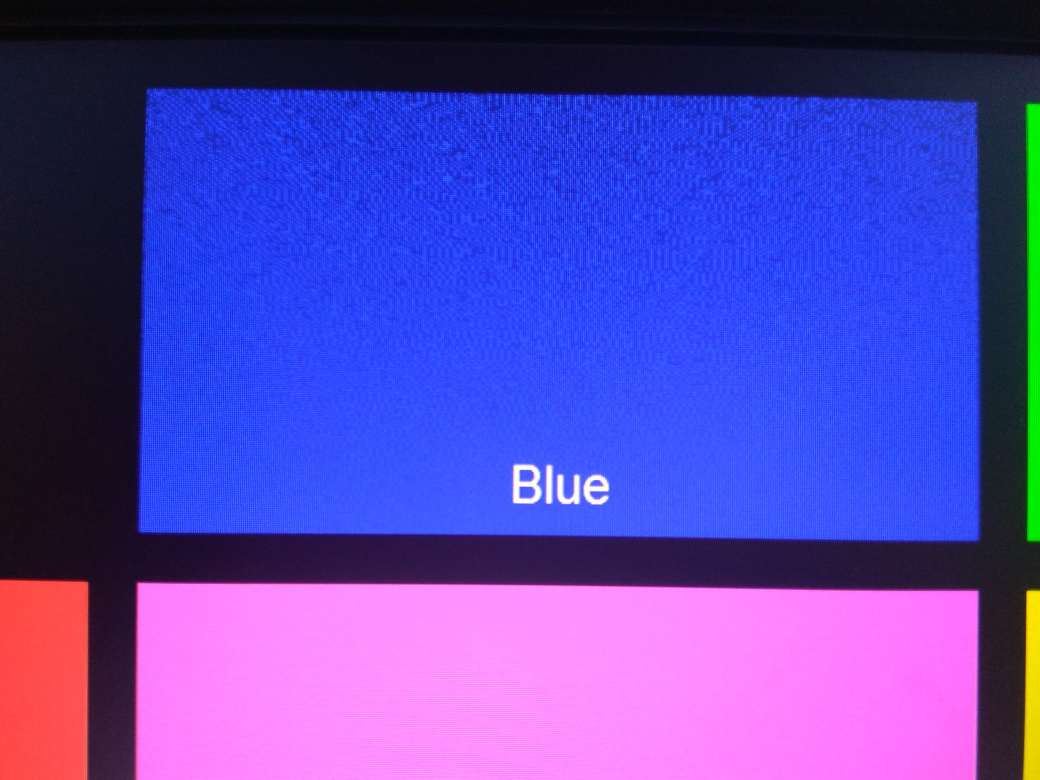

I'm trying to display YUV422 on LCD. Since, DSS does not support YUV422 output over discrete sync interface, refering to some posts on TI forum I found that the basic idea of how to get YUV422 is to "fool" DSS by saying that input YUV422 interleaved data is actually RGB565  and disable all pixel processing modules. I got YUV422 but the image is not 100% clear, it looks like it has  "snow noise"  on some colors.
DISPC_VID1_ATTRIBUTE (0x580010CC) register contains this value (0x8208880D)
Do you have some idea how to solve this?

  • Hi Nevena,
    Looking at the image, it looks like some bits are getting inverted.
    What is your output interface size?
    Atleast, colors are correct, so DSS is configured correctly.
    Rgds,
    Brijesh
  • Hi.
    The "snow noise" issue was related to some HW problem.
    When I changed the board LCD3 works fine, but for LCD1 and LCD2 instances, colors are swapped (red/blue). When I enable two
    pipelines for LCD1 or LCD2, the colors are in the right order.
