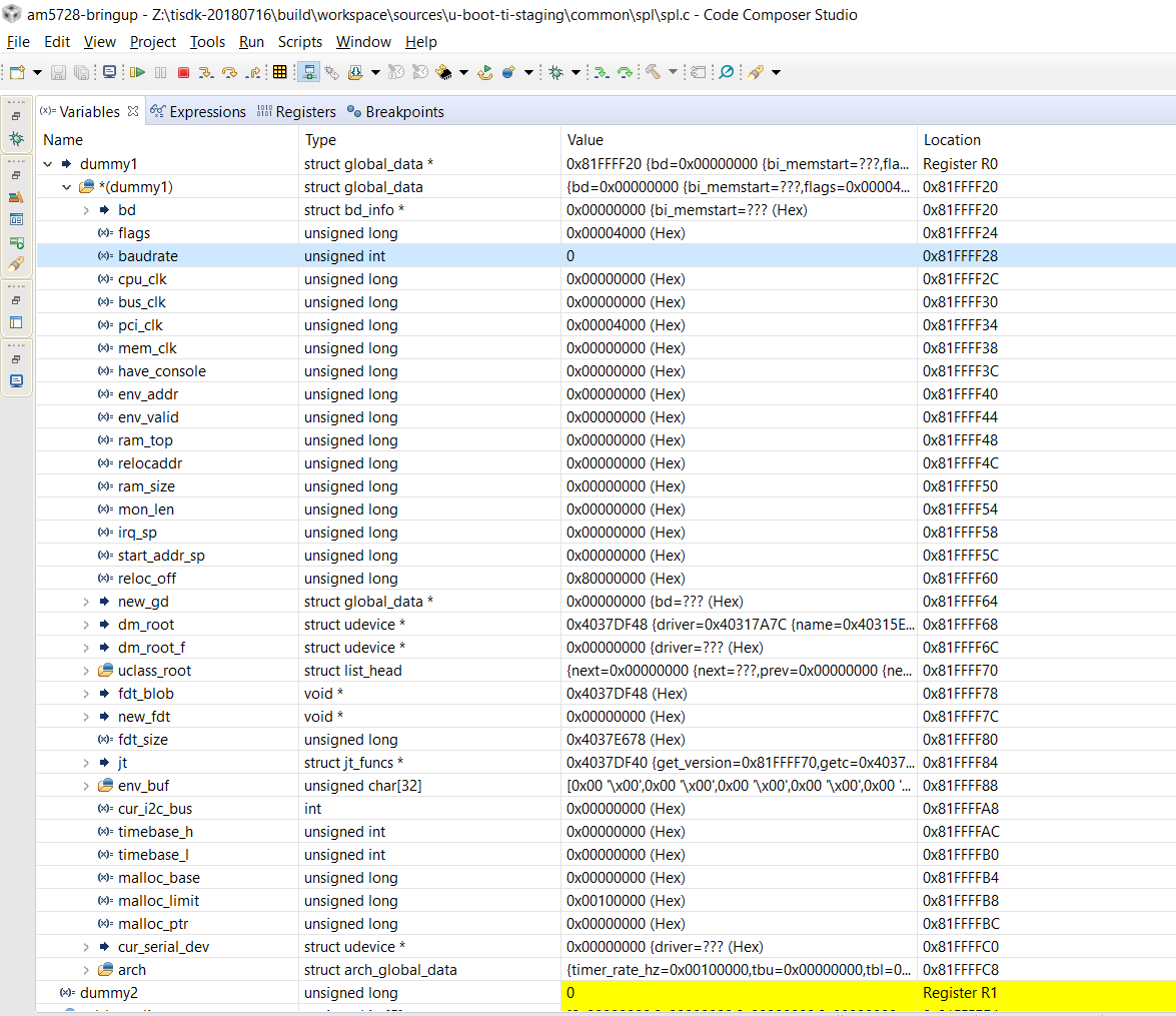

What's the location of gd for AM5728, before and after relocation in MLO(SPL)?
In the screenshot, I have what I think is the gd at 0x81FFFF20.
This is in board_init_r().
Does this look right at all..? I expect to see more valid data. No?
