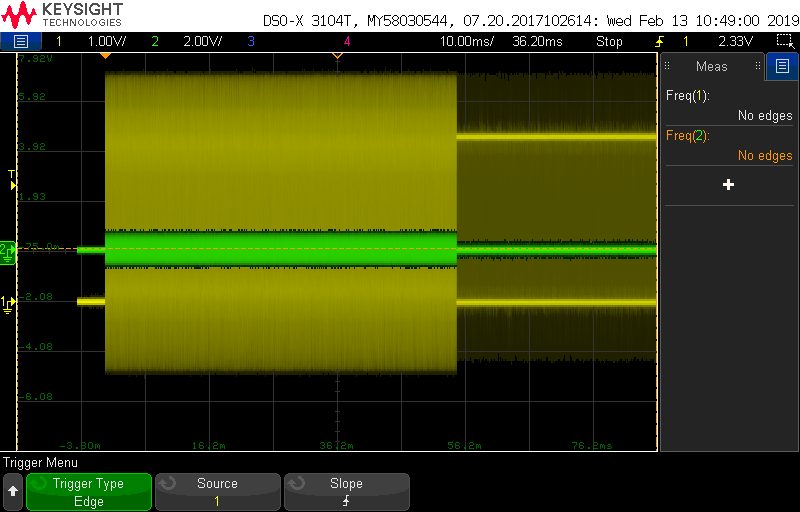

Hi, all.
I have intended use 1MHz PCM clock with 24.567MHz external clock.
So, I have changed device tree like below:

When I play 8kHz/16SE wave file with aplay, the PCM clock is unstable ~60ms. Below is capture of PCM clock.
Yellow signal is PCM clock, at the first, it has 25MHz frequency and changed to intened frequency (1MHz) after almost 60ms.
I have checked related register,
[   70.728173] @@@ CLKXCTL : 0x000000B7
[   70.731760]  CLKXP : 0x00000001, ASYNC : 0x00000000, CLKXM : 0x00000001, CLKXDIV : 0x00000017
I think it is no problem (24,576 / 24 = 1,024), can I get information how to remove the unstable PCM clock?
