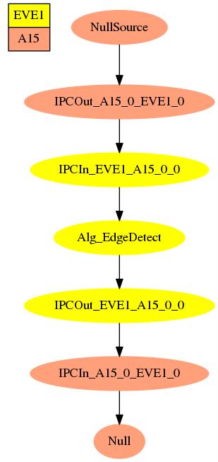

TDA2PXEVM: Does the SR1_FRAME_BUFFER can be accessed by EVE
Part Number: TDA2PXEVM
We create a usecase which need to access SR1 to get data by EVE. But it failed. I'm not sure that if the SR1_FRAME_BUFFER can be accessed by EVE. Please find the log in the attachment.

    UseCase: chains_NullSrc_EdgeDetect_Null
    NullSource(A15) -> Alg_EdgeDetect (EVE1) -> Null(A15)

    For this issue, Is there any good news?  I'm not sure if the link of IPCIn_EVE1_A15_0_0 is allowed to create. As the picture shown.
    Terence
  • Hi Terence,
    EVE is not directly connected to A15, it goes via IPU. So could you please connect to IPU and check if it is alive?
    Brijesh
  • Hi Brijesh,
    Replace it with IPU, it is normal. While, I find a test report that EVE is directly connected to A15 in chapter 16.2 of VisionSDK_DataSheet.pdf. This is just for BISO to BISO ?
    Thanks a lot for your support
    Terence
  • Terence,
    Not really, when you Linux on A15, ipc message from A15 to EVE goes via IPU, ie first A15 sends message to IPU and then IPU redirects this message to EVE. This is why i was asking if you have IPU enabled in your configuration..
    Can you please connect to IPU and check if it is alive?
    Rgds,
    Brijesh
