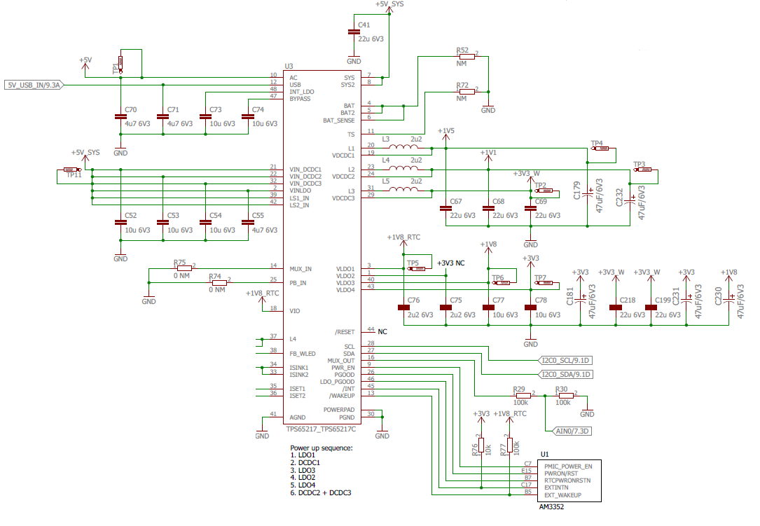

AM3352: Different readings on ADC depending on board power
Part Number: AM3352
Hi
I'm investigating a problem that has started to appear on numerous boards using the AM3352 processor. We've had boards running for a few years without any issue and suddenly on some newly produced boards we have started getting faulty readings on the ADC AIN6 input. We can see that the value read differs depending on how the board is powered. We're using the TPS65217C and when powered over USB the readings are ok but when powered over AC from the mains it returns the wrong value.
AIN6 Measurements
AIN6 Measure multi-meter +1V8 measure multi-meter AIN6 software measure
USB powered 0.235V 1.810V 0.232V
AC powered 0.247V 1.811V 0.342V
The schematics for the ADC is as follows.
And the TPS65217C
Attached you can also find a minimum code example that shows how we read the ADC input.
