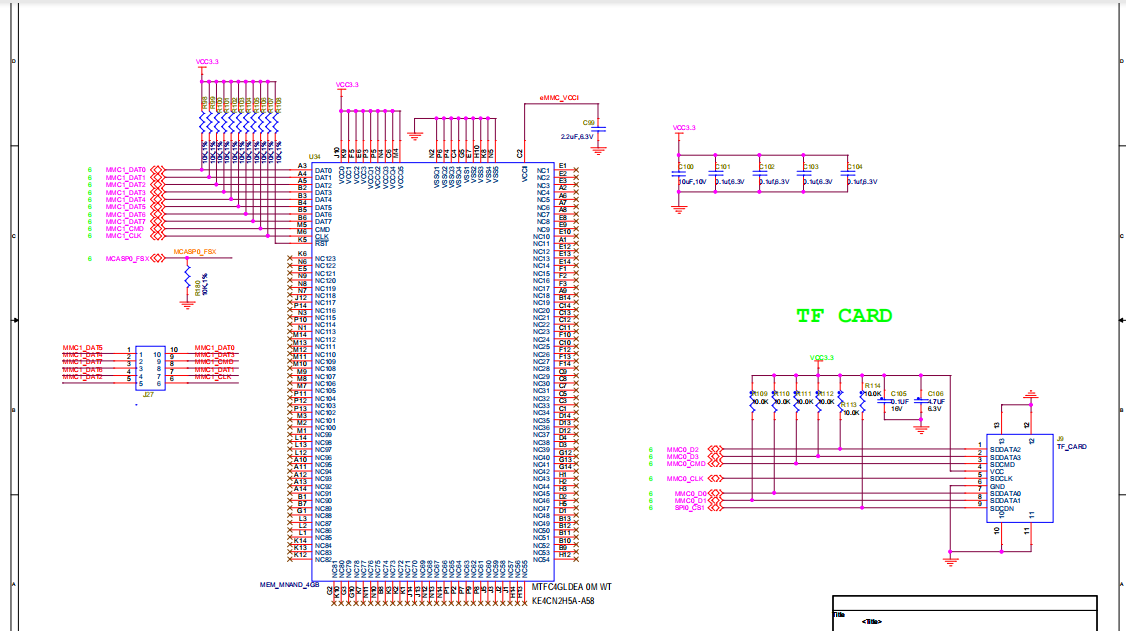

Dear all
How to configure eMMC in uboot ? eMMC is  MTFC4GLDEA-0M.
The MMC0 interface connect to TF which is u-boot, the MMC1 interface connect to eMMC
ti-processor-sdk-linux-am335x-evm-05.00.00.15-Linux-x86-Install.bin

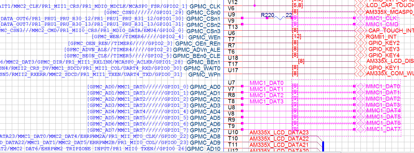

  • Hello Went,
    Enter the pinmux settings in your board's device tree and <Processor SDK>/u-boot-<version>/board/ti/am335x/mux.c file and that is all.
    Kemal

    static struct module_pin_mux mmc1_pin_mux[] = {
     {OFFSET(gpmc_ad7),  (MODE(1) | RXACTIVE | PULLUP_EN)}, /* MMC1_DAT7 */
     {OFFSET(gpmc_ad6),  (MODE(1) | RXACTIVE | PULLUP_EN)}, /* MMC1_DAT6 */
     {OFFSET(gpmc_ad5),  (MODE(1) | RXACTIVE | PULLUP_EN)}, /* MMC1_DAT5 */
     {OFFSET(gpmc_ad4),  (MODE(1) | RXACTIVE | PULLUP_EN)}, /* MMC1_DAT4 */
     {OFFSET(gpmc_ad3),  (MODE(1) | RXACTIVE | PULLUP_EN)}, /* MMC1_DAT3 */
     {OFFSET(gpmc_ad2),  (MODE(1) | RXACTIVE | PULLUP_EN)}, /* MMC1_DAT2 */
     {OFFSET(gpmc_ad1),  (MODE(1) | RXACTIVE | PULLUP_EN)}, /* MMC1_DAT1 */
     {OFFSET(gpmc_ad0), (MODE(1) | RXACTIVE | PULLUP_EN)}, /* MMC1_DAT0 */
     {OFFSET(gpmc_csn1), (MODE(2) | RXACTIVE | PULLUP_EN)}, /* MMC1_CLK */
     {OFFSET(gpmc_csn2), (MODE(2) | RXACTIVE | PULLUP_EN)}, /* MMC1_CMD */
     /*{OFFSET(gpmc_csn0), (MODE(7) | RXACTIVE | PULLUP_EN)},*/ /* MMC1_WP */
     /*{OFFSET(gpmc_advn_ale), (MODE(7) | RXACTIVE | PULLUP_EN)},*/ /* MMC1_CD */
     {-1},

  • I do not see the device tree. Can you post the device tree too?

  • Can you post the part of the schematic where the eMMC gets connected to the processor? Can you check whether switching to mmc1 partition works with the U-Boot image from the latest Processor SDK 05_02_00_10?
  • Software version:
    Schematic:
  • Hello user5841609,
    Your pinmuxes and schematic is okay. I think the initialization hangs in this mmc_init function. Can you put some prints, see where it hangs and dig into? Also enable and disable the CONFIG_IS_ENABLED(DM_MMC) and see if it has any affect. Simultaneously attach an oscilloscope on these mmc1 lines and check the activity.
