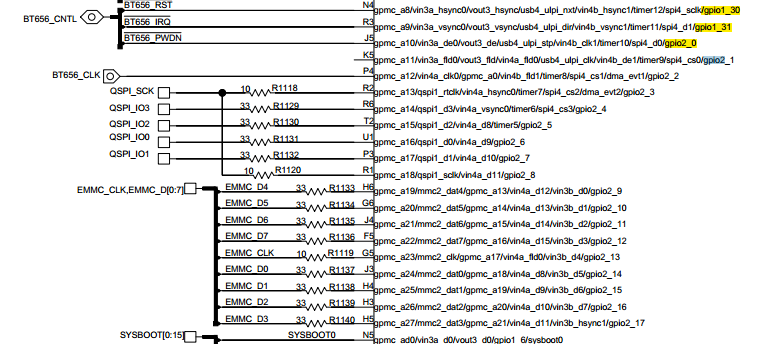

  • hi Rishabh,
    i refer the board design, gpio2 is pin mux as follow:
    best regards!

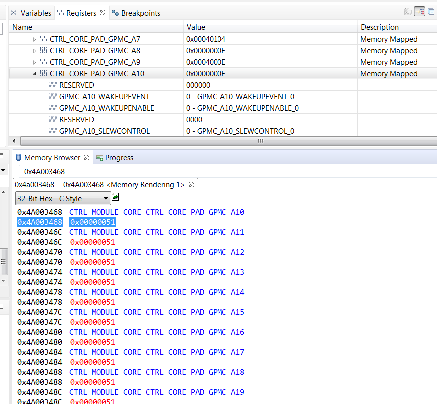

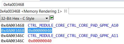

    Are you configuring pins GPMC_A10 and GPMC_A11?
    Can you read registers 0x4A00_3468 and 0x4A00_346C and tell me the value.
    Rishabh
  • hi Rishabh,
    i use CCS debug tool to connect A15 core, then i pause A15 to check two registers' value sometime is:
    sometime i continue to run A15 and pause again to check the value is:
    beset regards
    You need to set 0xE as MUXMODE for these pins to work as GPIO. You can refer to TRM for more details.
    Rishabh

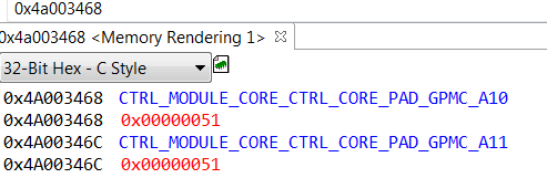

  • hi, Rishabh
    i sorry i feel confused, i read register value by "Memory browser" and Register is not same
    Can you please set HW watchpoint in the beginning of the program for GPMC_10 pin and see who all are writing to this register.

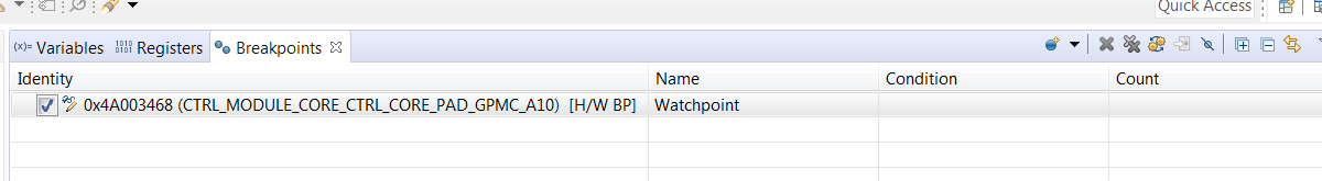

  • hi Rishabh,
    i add Hardware watchpoint by CCS like this:
    but it seem that it not work, no break happened, i am not load the firmware by CCS, i load the firmware of IPU2 from EMMC,  it is ok?  why breakpoint not be triggered?
    best regards!
    Break point will be triggered when you run via CCS.
    Can you add the pin mux change just before configuring/accessing GPIO and see if the same is working.
    Also make sure that no other CPU is running in parallel. You can halt other CPUs using CCS.
    Rishabh
