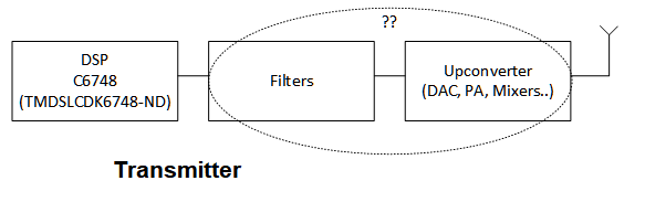

    (In the figure says 'modem', instead, transceiver is more appropiate).

  • It looked like from your last figure that you were looking for mixers, DACs etc and hence you should search for each part in a RF context and not search directly for SDR.

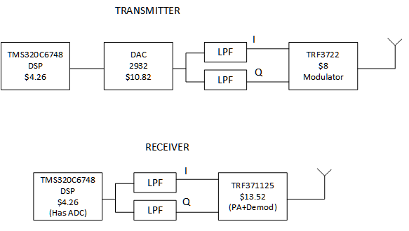

  • Well, in that case, would this work?
    I don't know what filters to utilize because i'd need them to be adjustable. We would be working mostly in Narrow Band
  • I believe you should at least include separate PA and LNAs. I have only worked with RF on chip so I haven't looked into what would be required to build up a complete radio with building blocks.
    This starts to be fairly complex. This would require that most of the settings in the system is fixed before students are starting to work with it and the model implementation in the DSP also require some work.
